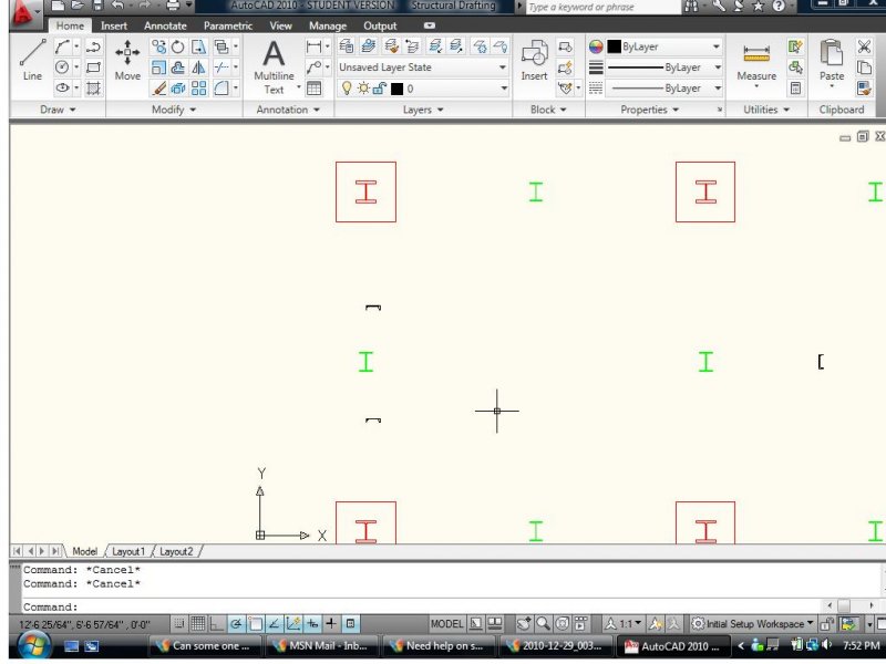

Autocadstudent Posted March 17, 2011 Author Share Posted March 17, 2011 may be am doing it all wrong. so if the yellow one is the w12x45 and the red one is the c9x20 i don't know what the color blue one is. this is what i got so far. am i in the right direction? Thank you. Quote Link to comment Share on other sites More sharing options...
nestly Posted March 17, 2011 Share Posted March 17, 2011 I remember this question now. Apparently the instructions describing the construction are not written very clearly. http://www.cadtutor.net/forum/showthread.php?55591-Need-help-on-structural-drafting-project/page2 http://www.screencast.com/t/c2ljZjL0x7 Quote Link to comment Share on other sites More sharing options...
SLW210 Posted March 17, 2011 Share Posted March 17, 2011 What he said, except I think the angle is supposed to be on the "backside" of the channel. Correct, I just threw something out there for him to get a visual, I have placed so many on the inside of the Channel I just did that out of habit.. The blue is the L1/2 x 4 x 4 6"Lg. I left out the bolts and bolt holes as well, I am not doing the project for him. If you plan on doing structural work, you need to get some related books, those are standard connections. http://www.google.com/#q=Structural+steel+books&hl=en&prmd=ivnsb&source=univ&tbs=shop:1&tbo=u&sa=X&ei=3veBTY2kKMS3tgfl8-nMBA&sqi=2&ved=0CEgQrQQ&biw=1253&bih=729&bav=on.2,or.r_gc.r_pw.&fp=5795f80f89536f59 Quote Link to comment Share on other sites More sharing options...

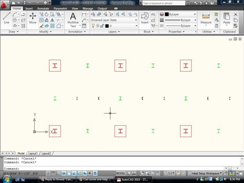

Autocadstudent Posted March 18, 2011 Author Share Posted March 18, 2011 Hey gusy i moved the c9x20 to this new location after seing nestly's video. i see the pink ones as w12x152 the orange as w12x45 and the blueones as c9x20 on the video is that right? am i drawing them as long as in the video or is my drawing looking ok? am going crazy guys please be patient with me. thank you. Quote Link to comment Share on other sites More sharing options...
nestly Posted March 18, 2011 Share Posted March 18, 2011 (edited) The rapidshare file is the same thing as the screencast video.... please don't pay for anything, I believe what you're trying to draw is the steel structure of something like a warehouse or a multi-story building. The W12x152's are the vertical columns and the W12x45's are the horizontal girders that form the main floor/roof structure and they span between the columns. The C9' are also part of horizontal roof structure and span between the W12x45's and are connected to the W12x45's with 4x4x6 angle clips as shown in the video. Edited March 18, 2011 by nestly Quote Link to comment Share on other sites More sharing options...

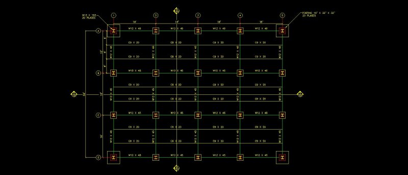

Car5858 Posted March 18, 2011 Share Posted March 18, 2011 The paragraph that was posted gives the discription of the details. This is the drawing of the OP's discription. Be very carefull as you read the instructions. I had to do one paragraph at a time. Remember that the instructions are not layed out in the correct draw order. Some of the instructions will be for other plates, or needed elsewere in the project. Quote Link to comment Share on other sites More sharing options...
