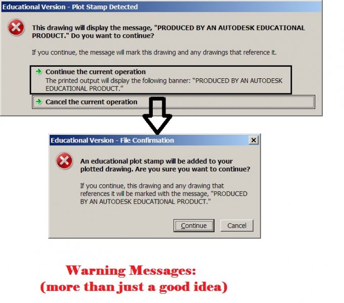

nestly
Kinda hard to miss, IMO

Cad64
Apparently no one at this company paid attention in class, or is paying attention at their workstation. :roll:
How can anyone miss that message? You have to click not once, but twice to get past the warnings and open the drawing. :?

When the student starts a new file in student version it gives them a warning.
And when someone tries to use edu content in commercial it gives them two warnings.
