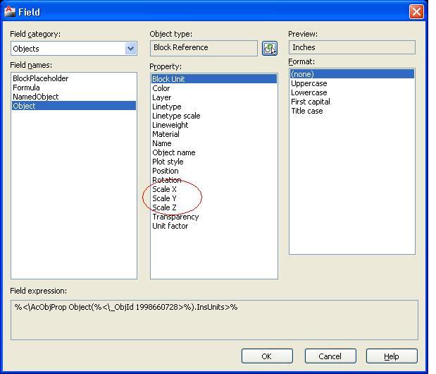

Grigs Posted May 3, 2011 Share Posted May 3, 2011 Someone came to me and asked if it was possible to draw a rectangle and have the x and y dimensions placed in the center along with a attribute. For example, you draw a 8'x10' rectangle and in the middle of it would be placed an editable attribute and right below it the X and Y dimensions of the rectangle. Is this doable? Quote Link to comment Share on other sites More sharing options...

BIGAL Posted May 4, 2011 Share Posted May 4, 2011 Do you need a dynamic block ? maybe a normal one of size 1x1 then scale x & Y is room size with attributes as fields = scale Quote Link to comment Share on other sites More sharing options...
SLW210 Posted May 4, 2011 Share Posted May 4, 2011 Do you need a dynamic block ? maybe a normal one of size 1x1 then scale x & Y is room size with attributes as fields = scale Good one BIGAL! I like that idea. Quote Link to comment Share on other sites More sharing options...
Grigs Posted May 4, 2011 Author Share Posted May 4, 2011 Where would one find the attributes as fields = scale? Quote Link to comment Share on other sites More sharing options...
qball Posted May 4, 2011 Share Posted May 4, 2011 As shown on the attached Quote Link to comment Share on other sites More sharing options...
Grigs Posted May 4, 2011 Author Share Posted May 4, 2011 Ok, I got that. I had to make the square a block first before the Scale X, Y and Z showed up. What I did was create a 1x1 square and made it a block, I then used the mText command to add the X and Y Scale fields. This works. But, if I try to make those into a block and scale it, the fields don't change. I have to explode it first then it will update when scaled. Quote Link to comment Share on other sites More sharing options...

qball Posted May 4, 2011 Share Posted May 4, 2011 scaling the 1x1 block seems complicated because you have to use the properties box and already know the x and y to scale. Because scale by reference scales uniformly, no? This might work (for rectangular rooms only) edit: no dynamic blocks in 2007 is there? roomtag.dwg Quote Link to comment Share on other sites More sharing options...
Grigs Posted May 4, 2011 Author Share Posted May 4, 2011 That works. Thanks Quote Link to comment Share on other sites More sharing options...
