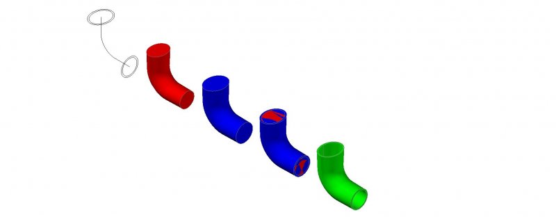

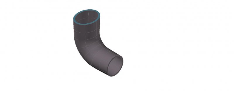

ORBIMAT123 Posted May 9, 2011 Share Posted May 9, 2011 Hi, I am trying to create a 3D elbow that is Ellipsed at one end and is circlular at the other. Im not sure how to go about making this and would be much apprecated for any help to do it ! I've attached and example of what im trying to make. Thanks Andy! Quote Link to comment Share on other sites More sharing options...
ReMark Posted May 9, 2011 Share Posted May 9, 2011 Elliptical or oblong? Use the Loft command with the Path option. It should work. Quote Link to comment Share on other sites More sharing options...

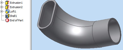

JD Mather Posted May 9, 2011 Share Posted May 9, 2011 I would loft between a couple of extrusion using centerline guide curve, union and shell. Quote Link to comment Share on other sites More sharing options...
ReMark Posted May 9, 2011 Share Posted May 9, 2011 Down and dirty example. Linework at upper left end and finished elbow at lower right. Probably could have eliminated a couple of steps had I used the Region command. Quote Link to comment Share on other sites More sharing options...
ReMark Posted May 9, 2011 Share Posted May 9, 2011 Using Region/Subtract first. Quote Link to comment Share on other sites More sharing options...
ORBIMAT123 Posted May 13, 2011 Author Share Posted May 13, 2011 hi guys! Thanks for helping me with this! sorry for taking so long to reply im just back at work. the loft tool worked great! thanks again! Andy Quote Link to comment Share on other sites More sharing options...
