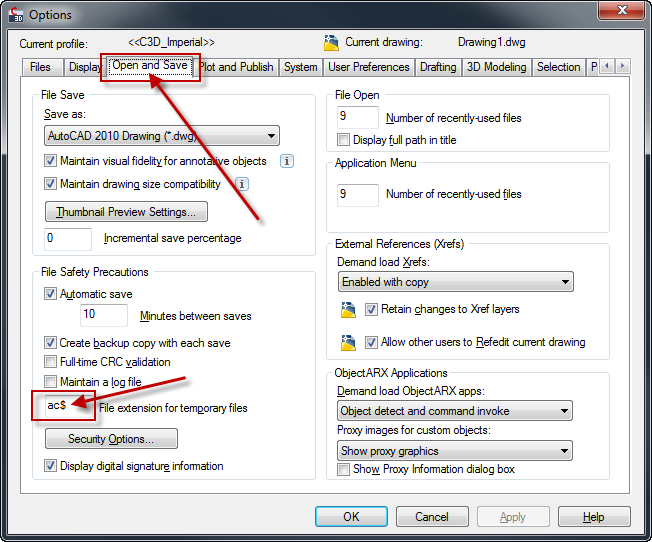

BlackBox Posted June 13, 2011 Posted June 13, 2011 I too have only experienced one, single .BAK being created for each .DWG during my work. Given that the .BAK files are also numerically sequenced (unless I've misunderstood the file naming convention?), is it possible that the autosave file extension was made to be .BAK, instead of the default OOTB extension? *IF* so, I'm not sure how these files would be placed in (getvar 'dwgprefix) in lieu of the profile's specified temp directory though. ... Just a thought. Quote
rkent Posted June 13, 2011 Posted June 13, 2011 I too have only experienced one, single .BAK being created for each .DWG during my work. Given that the .BAK files are also numerically sequenced (unless I've misunderstood the file naming convention?), is it possible that the autosave file extension was made to be .BAK, instead of the default OOTB extension? *IF* so, I'm not sure how these files would be placed in (getvar 'dwgprefix) in lieu of the profile's specified temp directory though. ... Just a thought. RenderMan - I think you are on to something there. OP, you will have to check on the offending operators computer to see if that has been changed. Quote
BlackBox Posted June 13, 2011 Posted June 13, 2011 RenderMan - I think you are on to something there. OP, you will have to check on the offending operators computer to see if that has been changed. Options > Open and Save Tab Quote
dbroada Posted June 13, 2011 Posted June 13, 2011 BUT the temporary files should be deleted on a clean exit. There should still only be .bak files UNLESS AutoCAD isn't exiting cleanly. Quote
rkent Posted June 13, 2011 Posted June 13, 2011 BUT the temporary files should be deleted on a clean exit. There should still only be .bak files UNLESS AutoCAD isn't exiting cleanly. Or he has Write but not Erase privileges. Quote
