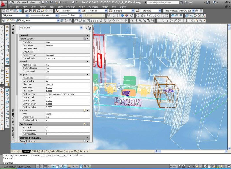

Hi, I am having a problem with output size when rendering. From Draft right through to presentation the output size is greyed out so I cannot change it. I've never had this problem before. Have I inadvertantly clicked on something which disables the output size?

post a screen shot.
Screen grab attached.
Any ideas??

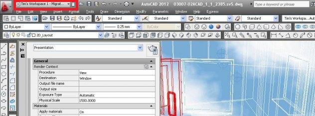

so your in Acad 2012, on the "tims workspace migration" up at top click it and select 3d modeling and rendering. you can always switch back later. Tell me what this does for you towards you problem.

Thanks Raudel. Switching to the 3D ribbon gave me access to the output size. When they first brought the ribbon out I couldn't get used to it so reverted back to old school drop downs. Think I may need to convert to ribbon now though. There are sooo many more rendering tools on the ribbon!!!
