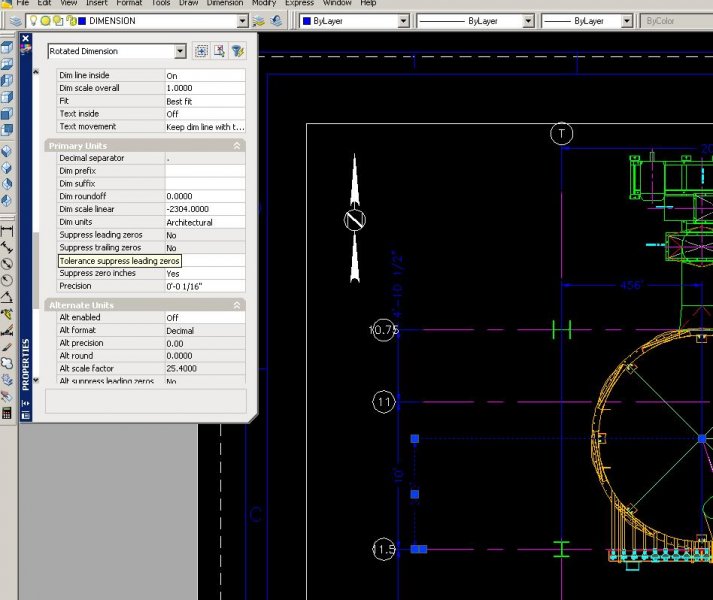

DANIEL Posted June 28, 2011 Posted June 28, 2011 My co-worker seems to have possibly corrupted an entire set of drawings with this issue, that being that any sort of dimensional manipulation reverts the scale facter to some squirrelly negative number. Does anyone know of a way of correcting this? And what has caused this in the first place? Quote
ReMark Posted June 28, 2011 Posted June 28, 2011 Does this mean there will soon be a job vacancy at your company? LOL Try setting both DIMSCALE and DIMLFAC to a value of 1. What happens? Quote
DANIEL Posted June 28, 2011 Author Posted June 28, 2011 it reverts back to -2304, no matter what number you put there. I can get around it by doing a match properties on a dim that still has the correct factor. ps. I can't fire him, I need him and have invested to much time in him. lol Quote

designerstuart Posted June 28, 2011 Posted June 28, 2011 i've not seen this problem coming from AutoCAD Architecture before. if matchprop fixes it, there must be some property in there that is causing the problem? what are the differences between a good and bad one? select one of each, and scroll thru properties, see which properties say VARIES. sorry if you've tried this already! can it be anything to do with the scale list? or is there some odd number set as a default? Quote
DANIEL Posted June 28, 2011 Author Posted June 28, 2011 I'm not away of any information having come from Architectual but it is possible as there are entities that were generated by outside companies inserted into these files. no worries stuart, i have compared the good with the bad and see no differences, mind you, matching the properties only works till you do something with the chproperties dimstyle or some sort of manipulation, through grips or what ever. Quote

DANIEL Posted June 29, 2011 Author Posted June 29, 2011 okay, while cleaning this up and severing my xreferences I desided to look at the dims and they work fine now ......... it has to be something in my base file and I can't give that out. Quote
DANIEL Posted June 29, 2011 Author Posted June 29, 2011 A victim of your own success. yes, unfortunately its a blank success lol, I think your on to something with the autocad architectual, whether that programs the cuplrit or not, i have an entity that has been brought in from an outside source thats causing this. Quote
