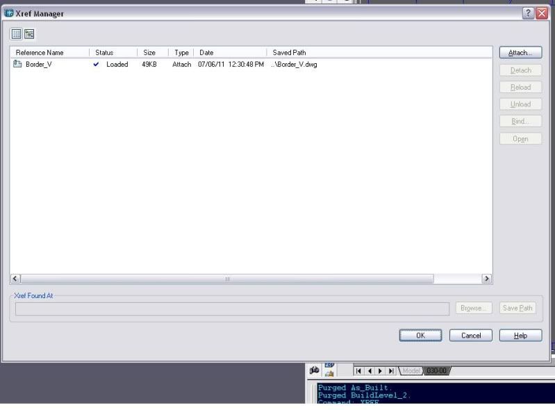

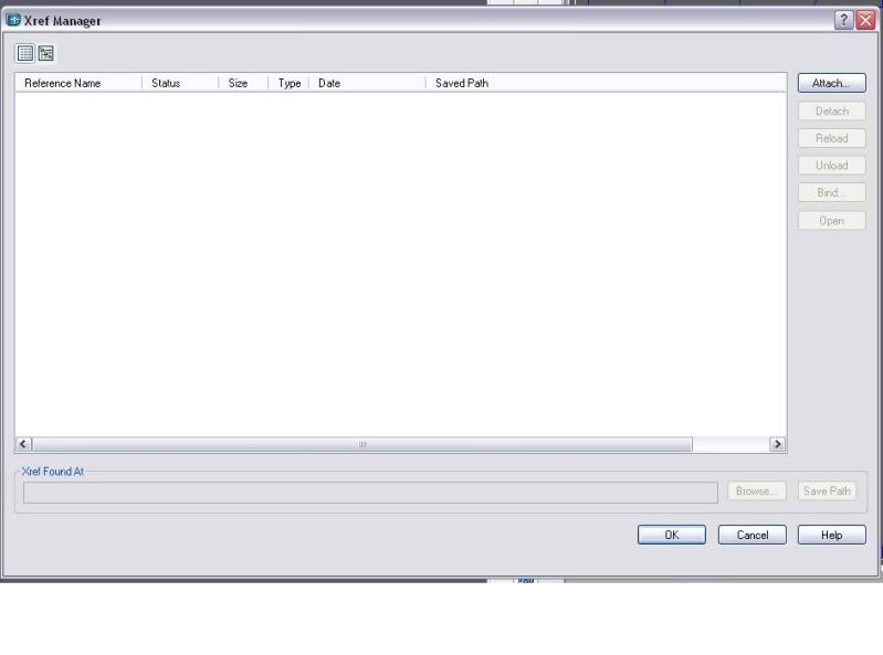

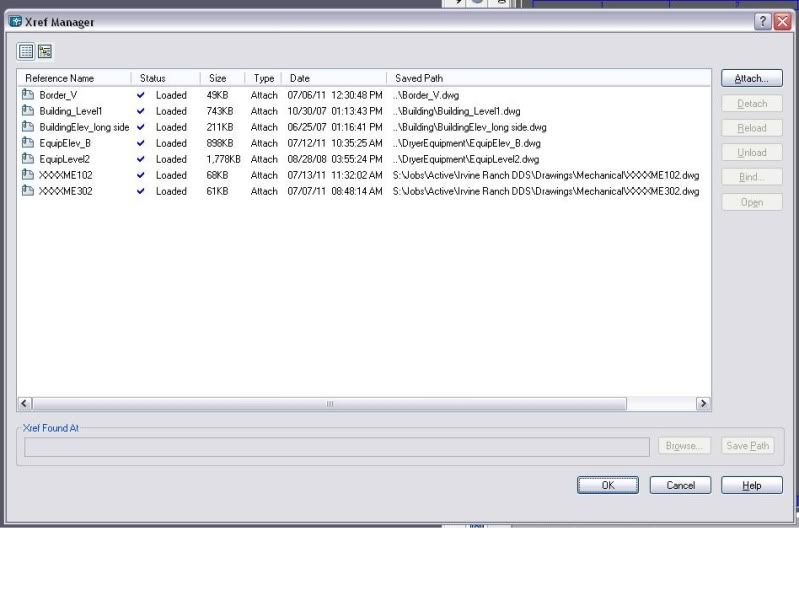

DANIEL Posted July 13, 2011 Author Posted July 13, 2011 here's what it looks like when he starts and is attempting to bind everything acept the border. he then selects everything accept the border, hits bind and then ok. it then looks like this. when he re-enters the xref command it then looks like this. Quote
Jack_O'neill Posted July 13, 2011 Posted July 13, 2011 Is "border_v" attached to any of those other drawings as well as this one? If it is, it would get bound by being nested, would it not? Quote
DANIEL Posted July 13, 2011 Author Posted July 13, 2011 Is "border_v" attached to any of those other drawings as well as this one? If it is' date=' it would get bound by being nested, would it not?[/quote'] yes its nest and attached to the file in use but ... we've been doing this for 7-8-9 years or something ... this is the first time anyone around here has ecountered this. Quote

DNK Posted July 13, 2011 Posted July 13, 2011 So it's the drawing. Can you bind only the titleblock? Quote
DANIEL Posted July 13, 2011 Author Posted July 13, 2011 So it's the drawing. Can you bind only the titleblock? no, the bind option comes up grayed out. Quote
DNK Posted July 13, 2011 Posted July 13, 2011 This means the titleblock is nested in one of the other (xrefed) drawings, and when it's bound so is the titleblock. I would detach each xref one by one to determine which it is, then deal accordingly. Quote
DANIEL Posted July 13, 2011 Author Posted July 13, 2011 This means the titleblock is nested in one of the other (xrefed) drawings, and when it's bound so is the titleblock. I would detach each xref one by one to determine which it is, then deal accordingly. i know which files have borders as well, whats causing this, this hasnt happened before, ever. Quote
Jack_O'neill Posted July 13, 2011 Posted July 13, 2011 You've got a circular reference there somewhere Daniel. A is xreffed to B, B is xreffed to C and C is xreffed to A. It won't let you do it because its already there. It may be several nests deep, but it's there somewhere. Almost has to be. I don't know why it's not detecting it and popping up the warning box, but I don't know what else it could be. Quote
SLW210 Posted July 13, 2011 Posted July 13, 2011 I cannot view your images at work, so my WAG is maybe you have the titleblock doubled up somewhere already as a block. Quote
DNK Posted July 14, 2011 Posted July 14, 2011 i know which files have borders as well, whats causing this, this hasnt happened before, ever. When you xref the titleblock, is it done as an overlay? Perhaps one of the files has it NOT as an overlay? Quote
