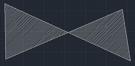

I think I ran across that one time - something like this:
That could be two separate hatches, or in this case a single object was selected, which is the polyline that crosses itself. An exaggerated example of course....
