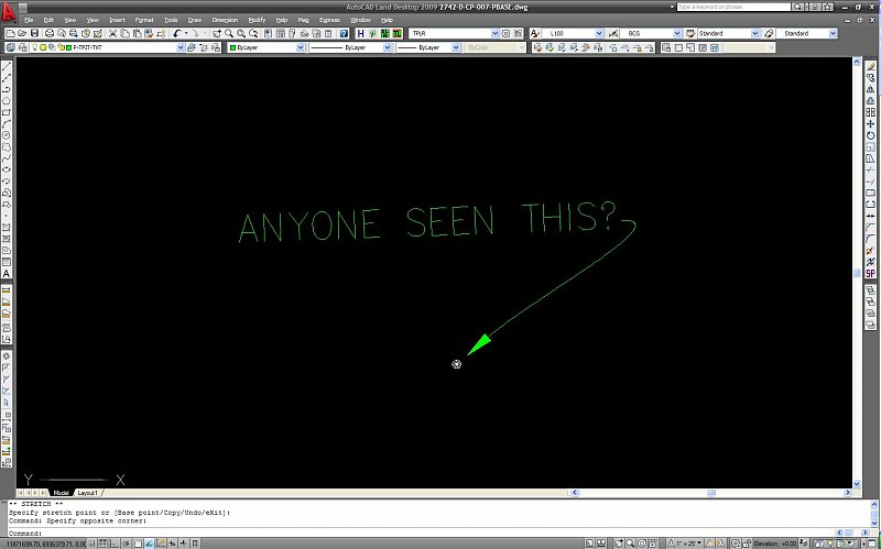

chulse Posted October 10, 2008 Share Posted October 10, 2008 Ok am I crazy or has anyone else seen this too? I can't select it, it scales with the screen and does not print... Quote Link to comment Share on other sites More sharing options...
BOB'27T Posted October 10, 2008 Share Posted October 10, 2008 I've ran into the same situation myself with points, feature lines and grading. Is the point on a layer with other points? I found that by doing a quickselect of all layer items, I was able to delete the item. Quote Link to comment Share on other sites More sharing options...

chulse Posted October 10, 2008 Author Share Posted October 10, 2008 It's a white hole (if you're using a black background). It's a black hole (if you're using a white background). That big atom smasher over in Europe is responsible. Let's kill all the scientists...let's kill 'em tonight. Who knows what evil lurks in the hearts and minds of men. :twisted: The Phantom knows! Wahhahhahhahhah. :lol: Dude- ease up on the coffee! White Hole about sums it up- I can't select it, don't know what layer it's on or what it is or where it came from... Darned atom smasher... Quote Link to comment Share on other sites More sharing options...
ReMark Posted October 10, 2008 Share Posted October 10, 2008 Thanks for the head slap chulse I needed that. Caffenine withdrawal. Is it just one drawing or every drawing? If it appears in more than one drawing does it show up in the exact same location? Could it be dead pixels that only show up when the background is completely black? Quote Link to comment Share on other sites More sharing options...

chulse Posted October 10, 2008 Author Share Posted October 10, 2008 Uggly! White background... and now a BLACK HOLE int he screen! Ok, back to black and all is right with the world (at least on screen...don't get me started...) Still there. Only on some drawings and not others. Not always int he same place either. Quote Link to comment Share on other sites More sharing options...

chulse Posted October 10, 2008 Author Share Posted October 10, 2008 it doesn't seem to follow the dwg to the file it's xrefed into Quote Link to comment Share on other sites More sharing options...

chulse Posted October 10, 2008 Author Share Posted October 10, 2008 Don't know? It has shown up on at least 2 dwgs that I inherited from clients (not the same one...) I didn't give it shrooms, honest... Quote Link to comment Share on other sites More sharing options...

eldon Posted October 10, 2008 Share Posted October 10, 2008 Drg TrueView said it was a Geo marker at Latitude 38.69, Longitude -77.14, Elevation 0.00 Quote Link to comment Share on other sites More sharing options...
chulse Posted October 10, 2008 Author Share Posted October 10, 2008 Eldon - Could you select it?? What Layer? Quote Link to comment Share on other sites More sharing options...
eldon Posted October 11, 2008 Share Posted October 11, 2008 No, I couldn't select it for listing, but when I put the cross-hairs on it, a small box came up on the screen with the information. You can switch it off with the GEOMARKERVISIBILTY variable. I typed geo-marker into Google and came up with this info. Quote Link to comment Share on other sites More sharing options...
