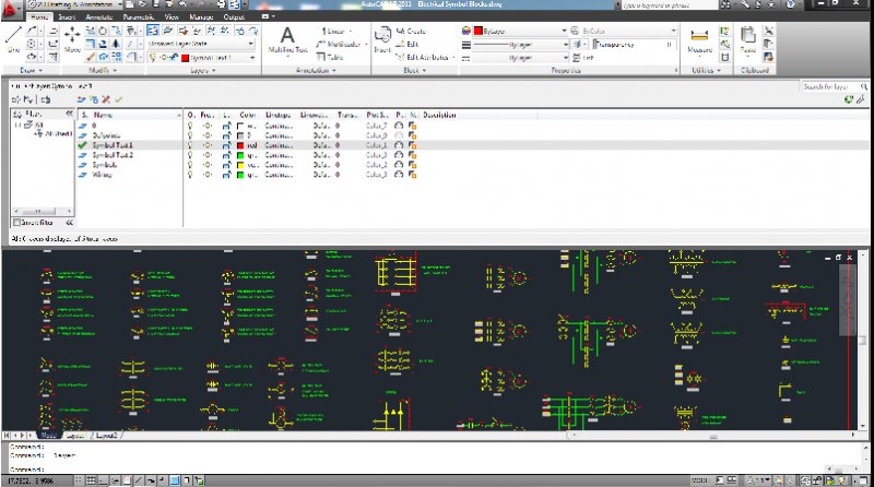

Acemon Posted August 23, 2011 Posted August 23, 2011 Somehow, in some way, I created a floating toobar for the layers manager. When I click on the layers property button, a "floating" version of it appears. I can close it, dock it, auto-hide it, etc., but can't get rid of it permanently. I'm using LT 2011, which feels odd after two decades of running the "full strength" versions. Quote

Acemon Posted August 23, 2011 Author Posted August 23, 2011 Clicking the layer button is supposed to open the Layers (palette), If you can close it, I don't understand how that's different than the intended behavior Do you mean that you want it to be closed when you start AutoCAD? Try closing it and saving your workspace. Clicking on the button typically opens the Layers Property palette but now it opens a very large floating version which is basically annoying. I'd love to know how to kill the floating version and go back to the "standard" palette. I saved the workspace, closed AC, then restarted. It seems to be a permanent change to the UI. Quote
nestly Posted August 23, 2011 Posted August 23, 2011 Can you post a screenshot of the "layers toolbar" Are you using the Ribbon, or a Classic workspace? Sometimes the CUI just gets confused, try switching workspaces and see if the same thing happens, then switch back. Quote

Acemon Posted August 24, 2011 Author Posted August 24, 2011 You want the old style layer property dialog. Try CLASSICLAYER as the command. Yes, that's exactly what I want, but when I close it and click the button on the ribbon, the docked/floating version returns. Here's a screencap: Quote
