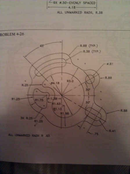

ReMark Posted September 21, 2011 Share Posted September 21, 2011 (edited) [ATTACH=CONFIG]30090[/ATTACH]Something like this. Where do you begin if your professor wants you to draw it to the give dimension? Something isn't quite right here at the base of the calipers. Edited September 28, 2011 by ReMark Quote Link to comment Share on other sites More sharing options...

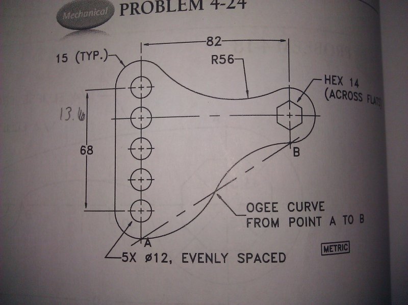

LOST NEWBIE Posted September 23, 2011 Author Share Posted September 23, 2011 I am taking the technical drawing class at tech for my engineering program. 4 weeks in and I have finally got him to do a drawing with the class. The whole class was only able to do about one drawing with him helping all the way through class 3 hours long. We have about 30 plus to due over the next month. I i truly had no idea were to start. I will have to do a lot of playing with it. I don't want anyone to do my drawings I want to see how things are done to apply them to my drawings. How can I show you what i am working on from my autocad program or from my flashdrive. Once again thanks for everyone who helps! Quote Link to comment Share on other sites More sharing options...

ReMark Posted September 23, 2011 Share Posted September 23, 2011 Start with clicking on the Go Advanced button in the lower right-hand corner of the Quick Reply box. Then look for the Paperclip icon. You'll have to upload your image or dwg file using the Browse button to find it. Attach your file and click OK. There is a Preview button too. Quote Link to comment Share on other sites More sharing options...

ReMark Posted September 26, 2011 Share Posted September 26, 2011 I don't see what the problem is. Take it a step at a time and do it logically. Start with laying out centerlines first then start adding the geometry. If you use circles instead of arcs then trim away what you don't need. Become familiar with the Circle > Tan-Tan-Radius command too. It can be a life-saver. So let's start with the first one. What would you do first? Where do you see yourself having a problem? Quote Link to comment Share on other sites More sharing options...

LOST NEWBIE Posted September 26, 2011 Author Share Posted September 26, 2011 ok i drew my center line for my circle and made my first circle on it ,and on that same center line and spaced my polygon 82 over to the right, i made my polygon(6 sided) on it (centerline/construction=green layer circle and polygon on object layer=white). If that is right I think i should finish the circles? How to do the all at the same time or aleast the bottom three below the center line Quote Link to comment Share on other sites More sharing options...
