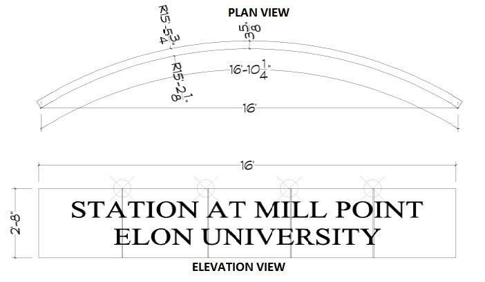

My problem is we need to have the lettering on the concave side of the sign. How would I make the flat lettering I have in the elevation shot follow the curve of the sign in the plan view?
I usually do most of my autocad drawing in 2d, I've done a few things in 3d but I'm not that experienced. I say that because I was thinking maybe I could make a 3d model of the flat elevation shot and bend it into radius I need.
Whats the best way to make this work?

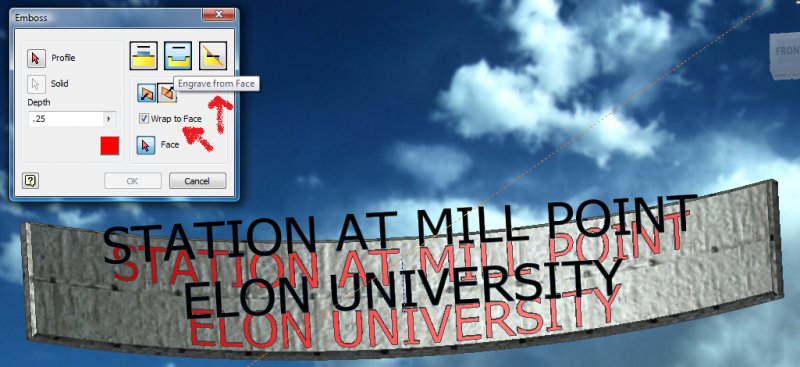

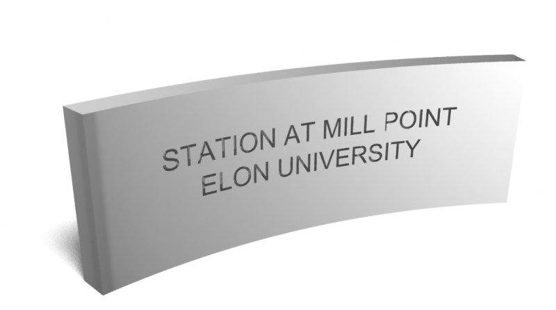

In a modern CAD program like Autodesk Inventor you could do an Emboss (engrave) feature with Wrap to Face to have the text wrap the curve.
Students and faculty can download Inventor for free from http://www.autodesk.com/edcommunity
I'll post example when I get a chance.
Edited by JD Mather
Whoops, wrong font.
I think I would download 30-day trial of Inventor - the AutoCAD method looks too much like torture.

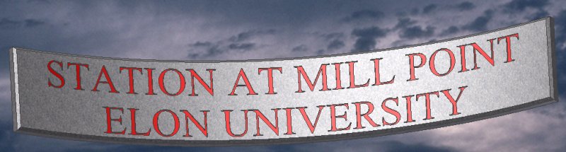

You guys make it sound like you're having a root canal. This took longer to render than it took to do. Create the text, explode it, clean it up, extrude the text far enough to reach through and subtract it from the wall. Draw another wall same as the first, only offset the inside of the curve the depth you want the text and union them. Presto, engraved lettering. Ain't hard.

Create the text' date=' explode it, clean it up, extrude the text far enough to reach through and subtract it from the wall. [/quote']
Sounds all wrong to me - doesn't match the real world geometry - post your file.
I sure hope if I ever have to have a root canal that the dentist does a better job.
I'm not sure what you mean by "doesn't match the real world geometry" but you are welcome to see the file.
If you are looking for a production ready document, no this ain't it. When you go to the monument maker, he will redraw the thing anyway to give an approximation of what you want based on what he can produce. Then you get to sit down and approve or revise based on his "real world" capabilities.
WALL - Standard.zip
Your text is not wrapped to the face.
All of the lines are parallel for every letter cutting into the curved face.
good work Jack
A trivially easy solution that is wrong.
I would have suggested the simple extrude if it was correct.
I do not consider something done incorrectly as "good work".
Now if you are referring to matching the actual dims from the original post, no its nowhere close. The object was to show the technique, not draw the sign for him.
Here's what I did:
Drew an arc, some random size. Then I offset that arc and connected the ends with a line. Then I copied that and offset the inner arc some distance and trimmed it. Then I made some mtext, scaled it up till it looked about right, exploded it, cleaned up the text so that presspull would create some solids. Positioned the "text" where it looked ok, and pulled it up far enough to reach all the way through the wall. Subtracted that to make holes in the wall. Extruded the smaller wall created earlier to the same height as the other one, matched up the outside corners and did a union.
Paid absolutely no attention to actual dimensions, or layers, for that matter. None of that mattered. The process is the same no matter what size it is. No, the letters aren't bent around like in JD's inventor solution, but they don't need to be. You will get what the monument maker can produce, and he will make his own drawings when you approve the design.
Now if you are referring to matching the actual dims from the original post' date=' ....[/quote']
No - I don't really care about the dimensions (other than the fact that extrude foreshortens the wrap and text position). I understood what you did before seeing the file. The cut sides of the letters should not all be the same direction resulting from extrude. I'm a bit surprised that this is fairly obvious. I guess it is more obvious when wrapping a cylinder.
