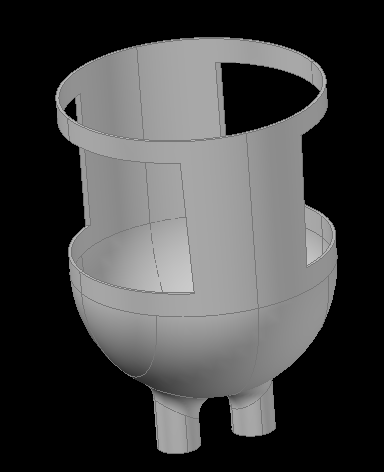

ReMark Posted October 16, 2011 Posted October 16, 2011 Not sure if you have the time to learn about AutoCAD meshes as JDM suggested. The jeans could probably be made using the profile of a flanged and dished head (as in tank fabrication). That would give you something similar to a "bowl" to put the upper body in. The "bib" front of the jeans could be made from an extruded profile and same goes for the straps over the shoulders. The legs you be created using lofted circles. Union everything together and you are good to go. Your professor should have had more common sense than to let you attempt this as your final project. I'll bet the class did not come close to even discussing ways to do something similar. Quote
JD Mather Posted October 16, 2011 Posted October 16, 2011 Thinking about it using standard geometry tools is the wrong way to go. Rectangular box subdivided into many square faces. Push and pull the faces to get rough shape. Smooth the model. Color Faces. Ask your prof to demonstrate how to do something like this BEFORE giving an assignment. Are you actually paying tuition (or the taxpayers) for this class? Give the trouble you had with something as simple as a wheel - drop the class. You haven't been taught (or learned?) the basics needed to complete the assignment. Quote

Jack_O'neill Posted October 17, 2011 Posted October 17, 2011 This is one revolve, one subtract, two press-pulls, one copy, one union and two fillets. The one in the cartoon is more elongated, this one is round. You could use a sweep around an oval to get that instead of the revolve. So before the flame war starts, I know its not perfect, I never said it was perfect, it's not even a copy. I stipulate to all the arguments that it can't possibly be done the way I did it, so lets skip all that. Drew the shape of the body with a straight polyline and an arc. Offset it 1/8" closed the ends and revolved it. Drew a rectangle, presspulled it through the body and subtracted it. Two circles to represent one of the legs, presspulled them up into the body, copied it over to the other side to make the other leg and unioned them. Filleted the edge where the legs went through the body. Don't have time to draw the buttons and the pocket, or to refine where the straps meet the buttons. This is offered simply as a place to start. Took about 10 minutes to do. If somebody dont' like it, or how it was done, I don't care, and don't want to hear it. Quote
