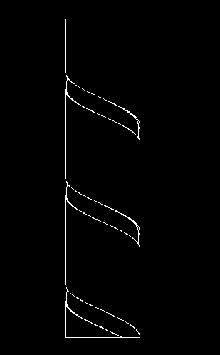

the180fury Posted October 23, 2011 Author Posted October 23, 2011 Yes absolutely, what i'm trying to do is actually draw up the column in 2d with as much info as possible (almost there hopefully another hour or two pending work distractions) the fillet which is spiraling up the column if you can imagine like a ribbon I can not draw in 2d on my software, maybe unless I freehand it. So hopefully when i attach what i can do from my side shortly it will make more sense. I really only need front and top view of said column for this project but if i could also get a 3d version would be great. Quote

the180fury Posted October 24, 2011 Author Posted October 24, 2011 Yes if you can imagine looking at the column front on you would see the fillet appear almost like an s shape not like the straight 45 degree line i have run through on the angle so in other words the ends as you see wrap around the column have a radius applied hence the ramp and twist. Quote
Jack_O'neill Posted October 24, 2011 Posted October 24, 2011 Yes if you can imagine looking at the column front on you would see the fillet appear almost like an s shape not like the straight 45 degree line i have run through on the angle so in other words the ends as you see wrap around the column have a radius applied hence the ramp and twist. Sorry, I dozed off watching TV last night. Is this what you are trying to do? This one doesn't match your column, but we can make it match. I just wanted to see if that was the look you were after without spending gobs of time on the details. Quote
the180fury Posted October 24, 2011 Author Posted October 24, 2011 YES !!!!That is exactly what i am trying to do Don't mean to be pushy but how soon could you knock one of these out to suit? Quote
