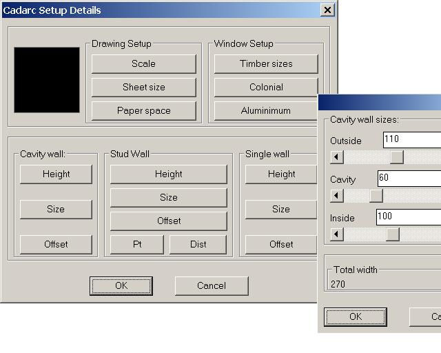

BIGAL Posted November 8, 2011 Share Posted November 8, 2011 Draw a picture of your dcl required and what type of values required you can have sliders, pick from list, yes no, predefined or blank, multi pane lots of stuff post an image here Secondly look up help it does have examples of how to do dcl's Quote Link to comment Share on other sites More sharing options...

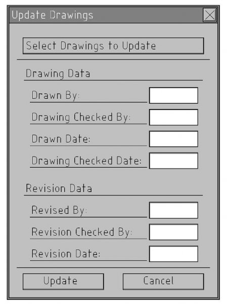

lamensterms Posted November 8, 2011 Author Share Posted November 8, 2011 hi BigAl, thanks for your reply. .... is a very basic example of how i might like the dialogue box to look. Pretty much just prompting the user to input a string value which will be assigned to the corresponding tag in each block in each DWG selected. Eventually i might like to add more tags to edit, maybe an option to purge each drawing as the routine runs. Ill certainly take a closer look at the help section, i have also been checking out some of the tutorials at afralisp.net. Thanks for all your help mate. Quote Link to comment Share on other sites More sharing options...

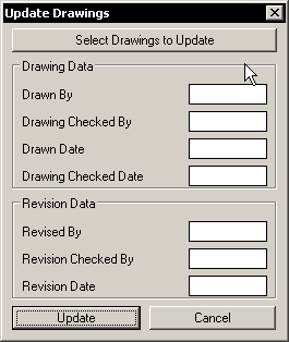

irneb Posted November 8, 2011 Share Posted November 8, 2011 Well here's the DCL code to make that dialog: DwgUpdate : dialog { label = "Update Drawings"; : column { : button { label = "Select Drawings to Update"; key = "select"; } : boxed_column { label = "Drawing Data"; : edit_box { label = "Drawn By"; key = "drw"; edit_width = 10; } : edit_box { label = "Drawing Checked By"; key = "chk"; edit_width = 10; } : edit_box { label = "Drawn Date"; key = "ddate"; edit_width = 10; } : edit_box { label = "Drawing Checked Date"; key = "cdate"; edit_width = 10; } } : boxed_column { label = "Revision Data"; : edit_box { label = "Revised By"; key = "rdrw"; edit_width = 10; } : edit_box { label = "Revision Checked By"; key = "rchk"; edit_width = 10; } : edit_box { label = "Revision Date"; key = "rdate"; edit_width = 10; } } : row { : button { label = "Update"; key = "accept"; action = "(done_dialog 1)"; is_default = true; } : button { label = "Cancel"; key = "cancel"; action = "(done_dialog 0)"; is_cancel = true; } } } } Looks like this: Quote Link to comment Share on other sites More sharing options...
