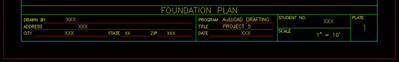

chovek Posted November 27, 2012 Share Posted November 27, 2012 I have a problem with this point, I can not figure out what to draw Box out the title block by drawing a line 1″ from the border’s right side. Draw it on Layer Border2, assigning this layer a green color and a continuous linetype. As an alternative, you could OFFSET the border line 1″, use CHPROP to change the new polyline to Layer Border2, EXPLODE the polyline, ERASE the top, and EXTEND the line to the cyan border. my problem is because my English is not so good sometimes Quote Link to comment Share on other sites More sharing options...
ReMark Posted November 27, 2012 Share Posted November 27, 2012 This is what one student came up with. He placed it vertically on the right-hand side of his sheet. So imagine it turned 90 deg to the left using the lower left hand corner as your pivot point. Quote Link to comment Share on other sites More sharing options...
chovek Posted November 27, 2012 Share Posted November 27, 2012 oh thanks, now I know how you really ... the title block just have to be on the right side Quote Link to comment Share on other sites More sharing options...

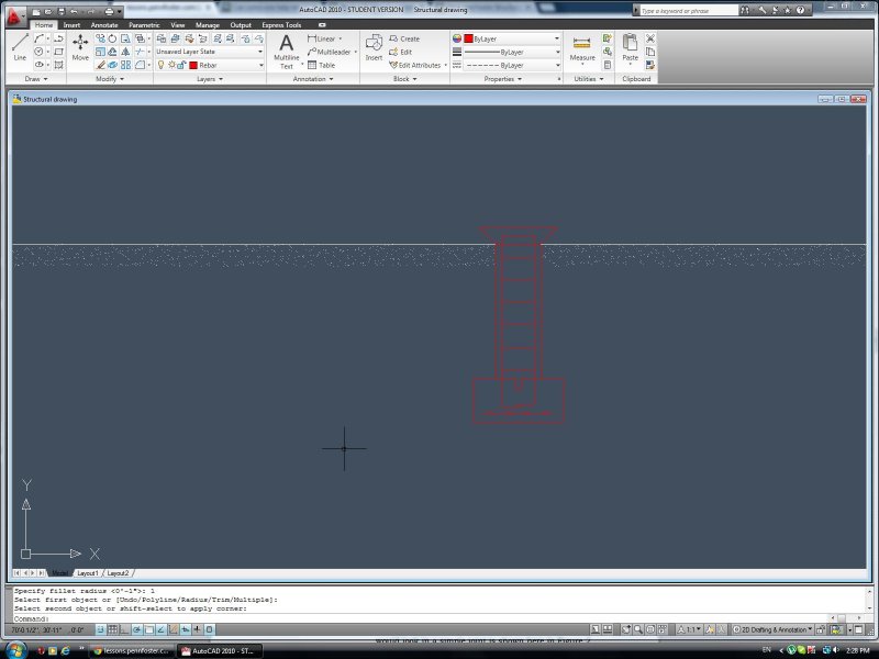

chovek Posted December 17, 2012 Share Posted December 17, 2012 I'm on the plate 2,can you check this,I'm not sure rebar is correct Quote Link to comment Share on other sites More sharing options...
ReMark Posted December 17, 2012 Share Posted December 17, 2012 Sorry but the image is difficult to see clearly therefore I cannot comment one way or the other. Penn-Foster leaves this so vague its possible to come up with more than one way to show the rebar. Quote Link to comment Share on other sites More sharing options...

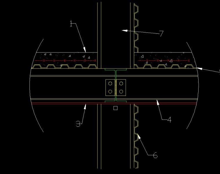

geussb Posted January 9, 2013 Share Posted January 9, 2013 im working on the structural project, plate6. i was wondering if i am doing this right? it says show how the beam is connected to the girder. so is that just the angle bracket that shows the girder connected to the C9x20? and also the vertical beams? Quote Link to comment Share on other sites More sharing options...
geussb Posted January 9, 2013 Share Posted January 9, 2013 here is what i have so far Quote Link to comment Share on other sites More sharing options...
ReMark Posted January 9, 2013 Share Posted January 9, 2013 They are not vertical beams; they're called columns. Aren't the beams that run east/west supposed to clip into the column? I don't think the design has one beam clipped into another. Don't the C9x20 channels sit on the top of the bottom flange of the W12x45 girders? You have your C9 centered between the flanges. Check the instructions. It looks like you have your concrete, rebar, decking and ceiling passing right through you column. That would be incorrect. Quote Link to comment Share on other sites More sharing options...

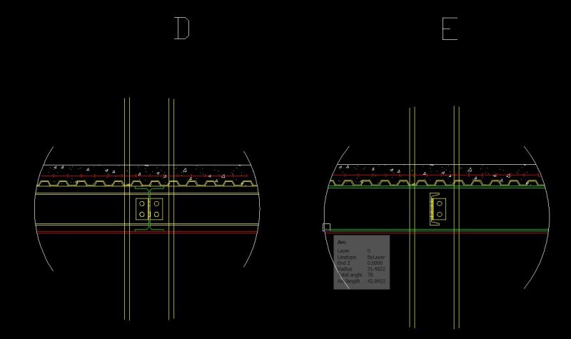

geussb Posted January 9, 2013 Share Posted January 9, 2013 does this look better? Quote Link to comment Share on other sites More sharing options...
geussb Posted January 9, 2013 Share Posted January 9, 2013 crap minus the ceiling tiles still through the column Quote Link to comment Share on other sites More sharing options...
ReMark Posted January 9, 2013 Share Posted January 9, 2013 Sorry, but I don't think the image above is correct. There are no beam to beam connections on the interior. All beams connect to columns don't they? Quote Link to comment Share on other sites More sharing options...
geussb Posted January 9, 2013 Share Posted January 9, 2013 i dont know? penn foster just assumes we should know all this, i have no idea how its supposed to work or it would be right the first time. hence the many questions Quote Link to comment Share on other sites More sharing options...
ReMark Posted January 9, 2013 Share Posted January 9, 2013 Look at the plan view of your column layout. Do you see any beams that do NOT terminate either at the face of flange on a column or at the face of the web of a column? Unfortunately I've got to go out into the plant for a couple of hours so I have but 10 minutes left to assist. Tag. You're it. Time now 2:16 pm EDST Quote Link to comment Share on other sites More sharing options...
