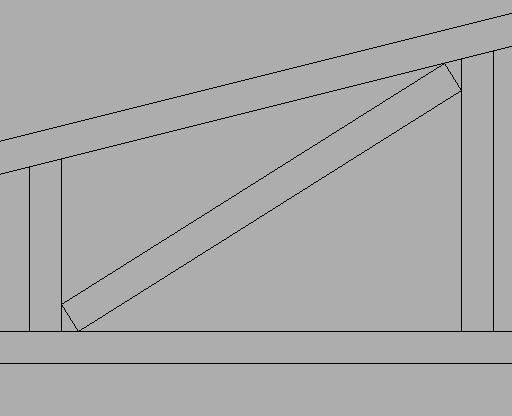

HCb Posted November 28, 2011 Posted November 28, 2011 Hey, all, this may be stupid-simple but I cannot figure it out (I'm a builder, not a draftsman...so far). If I need to post this somewhere else, please let me know. Attached is a file. I'm trying to draw a truss I'm going to build a number of. I want to throw in a diagonal brace between a couple of uprights on each side. I want the brace piece to have square ends, not diagonal cuts. I want the brace piece to fit into the space between two parallel vertical pieces and the horizontal and diagonal piece with, hopefully, all four corners of the rectangular brace piece touching the bounding pieces (I'm not sure this is possible). I'm not sure how to go about drawing the brace piece (shown in magenta in the file on the PurlinSupports layer). I've tried a number attempts but modifying the position/angle at one end mucks up the other end. If this is possible to draw it right in one try (without a bunch of hack work) then it's probably something sexy/simple (like bisecting a line with a compass) but I haven't figured it out. My hacking attempts are on the left in the drawing, my depiction of what I'm looking for as a final product are on the right in the drawing. I'd love some help. Thank you. --HCTrussTest.dwg Quote

HCb Posted November 28, 2011 Author Posted November 28, 2011 What are you using to construct your truss? Wood or steel? If you are using steel, what structural shape will be used for the chords, verticals and braces? Thank you for the reply. I'm using 2x4 rectangular steel tubing, 11ga. I'm thinking that there should be a way to draw a maximum-length piece of the same material in the diagonal position shown in the file without a bunch of trial and error. I'd like to be able to do this for multiple projects, each one with different roof pitches and vertical brace spacing. --HC Quote

Dana W Posted November 28, 2011 Posted November 28, 2011 Thank you for the reply. I'm using 2x4 rectangular steel tubing, 11ga. I'm thinking that there should be a way to draw a maximum-length piece of the same material in the diagonal position shown in the file without a bunch of trial and error. I'd like to be able to do this for multiple projects, each one with different roof pitches and vertical brace spacing. --HC Oh, OK. Then what you want is a dynamic block of the part you need. This block would have a lengthwise stretch action. You could insert the block, stretch it, then rotate it into place, or add a rotational action to the block too. Another way would be to simply draw a rectangle of the required size, and rotate it into position. Quote

HCb Posted November 28, 2011 Author Posted November 28, 2011 The geometry that you are trying to construct does not have a simple solution in basic AutoCAD, although some different versions may be able to do what you want (someone may mention Inventor). If you are at an educational establishment, you could download it for free. Structurally, what you are drawing goes against the premise that the centre lines of all members at a joint pass through a common point, otherwise there is an out of balance force at the joint. I wonder why no-one has thought of this layout before? Perhaps the geometry is too tricky for techniques available until now. Probably your easiest solution would be to try a full scale set up, so that your square ended timber takes up its own position at one end, whilst you mark up the other end Hey, Eldon, thank you for your reply. I'm no longer a student so I cannot download the edu licensed Inventor. Maybe a 30-day trial or something. Structurally, I'm not a professional engineer. I have an engineer who has defined the materials to be used and the diagonal and horizontal parts of the truss are more than adequate (he tells me) for the compression and tension loading on the respective members. The material comes in 24 foot lengths and, when cut to length, gives me a few drops. I'm trying to use some of the drop to add additional bracing to the truss. I have done what you suggest (set up a full-size piece and cut to fit), but I was thinking there might be a way to do it in CAD so I know ahead of time. I've built trusses that clearspan 48 feet using the same basic principle and which have handled a 6+ inch snow load on a 3:12 pitch. I cut those diagonal members (there were more of them in my longer trusses) in the manner you suggest...lay it up there and mark it. Thanks again. --HC Quote
