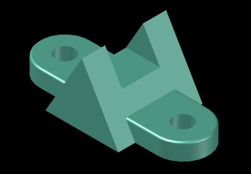

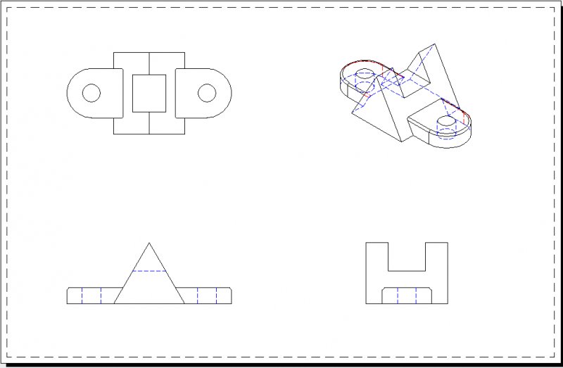

ReMark Posted December 7, 2011 Posted December 7, 2011 Credit JDM for bringing this command to my attention a while back. Just got around to experimenting with it. VIEWBASE works only in a layout. It does not create blocks like the SectionPlane and Flatshot commands do. It does create some unique layers such as Hidden, Hidden Narrow, Visible and Visible Narrow. A change to the 3D geometry can be reflected in the 2D views that are created via the View Update command. Multiple orthographic views can be created at one time using the Projected View option. It works simply and fast. My simple 3D wedge base. The four resultant views created with VIEWBASE. Quote

rkent Posted December 7, 2011 Posted December 7, 2011 What is the difference between VIEWBASE and the SOL commands? The main one is that any change to the model is shown in the viewbase views, no need to redo anything. They are much quicker than SOL commands also as the 4 are made at once with simple moving of the cursor. Quote
ReMark Posted December 7, 2011 Author Posted December 7, 2011 (edited) VIEWBASE is much faster. It does not create as many layers as SolView/SolDraw. There is no geometry created over in model space. VIEWBASE supports only the following orientations: Top/Bottom/Left/Right/Front/BAck/SW iso/SE iso/NE iso/NW iso. There is no option for creating a Section or for Hatching as far as I can tell. 2D views can be easily updated when there is a change to the 3D geometry. Not only does VIEWBASE create the new layers, it automatically assigns the linetype and even a lineweight for each layer. One can pre-select first or third angle projection. Preview type: Shaded or bounding box. Other options available in VIEWBASE are: Representation/Orientation/STyle/SCale/Visibility/Move/eXit. Cannot "copy" a view. AutoCAD returns the following: Cannot COPY that object 1 found 1 was filtered out, 0 total Cannot use the BEDIT command on a view because it isn't considered a block. I'm sure there is more but I'm still experimenting with the command. Edited December 7, 2011 by ReMark Quote

Dadgad Posted December 8, 2011 Posted December 8, 2011 (edited) If the use of standard orthographic views is not a problem, VIEWBASE is probably the faster, and as the projections it generates are associative in nature, one is assured that the projections are up to date (unless of course they have red flags on their corners, indicating the need to update the projection). SOLPROF is more intuitive and allows one to set up whatever perspectives are required. Yes, new layers (as in the other SOL commands) are generated, but they can be LAYMRGed into your chosen standard layers, or renamed to suit. If you rename the layers, those names will be used the next time you run VIEWBASE. VIEWBASE is used without the need of a viewport, but if there is need for a nonorthographic view, a section or whatever, one can be added in whatever way seems appropriate to a viewport on the same drawing layout. I never had too much luck with SOLDRAW & SOLVIEW, was glad to discover SOLPROF. So many different ways to go. To each his own, variety is the spice of life. Lamentably the VIEWBASE generated projections will not display on versions of AUTOCAD prior to 2012. Inventor models provide further enhancements to the VIEWBASE display options which are not supported for AUTOCAD models. Looking forward to improvements in this command, clearly in development, and will certainly get much better. Edited December 8, 2011 by Dadgad more grist for the mill Quote
