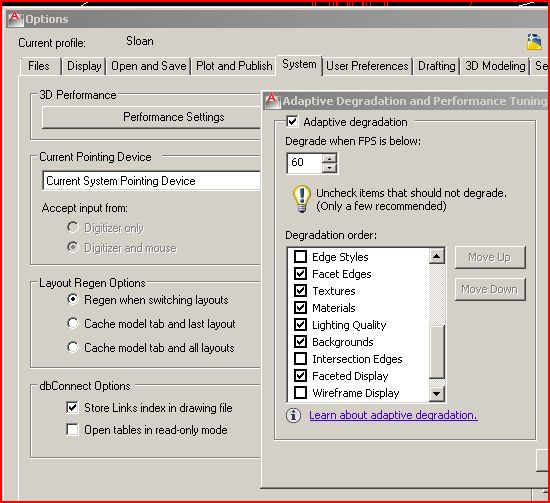

Dadgad Posted December 19, 2011 Share Posted December 19, 2011 (edited) I am a big fan of SOLPROF. What you say is true about the fact that it is not automatically updated, and so, should be used when the model is completed. When I set up my models prior to using SOLPROF, I explode any blocks first, as it only works on 3D solids, then I strip out any bits which I do not want to display on any particular perspective view. Before running Solprof I always check from an isometric perspective in modelspace to ensure that nothing has inadvertently been rotated erroneously, which would of course affect the layering (visible or hidden) in the solprof blocks. I use 2D wireframe view setting up my perspectives, it occasionally happens, and from top view I can't tell. If you are running these commands with realistic, xray or hidden view styles, it will really slow you down, and might cause your PC to crash. After using the SOLPROF command I separate the PH and the PV blocks by dragging them a know distance orthogonally in different directions. I explode those blocks, then I use the OVERKILL command to strip out any uncalled for duplicated lines. Then I select all of the exploded bits from the PH block and change their layer to Steel Hidden, and I set their DRAW ORDER to display at the back. I then choose and move all of the PV bits to the Steel layer, and set their DRAW ORDER to display in the front. Then I move the 3D models which were just solprofed out of the way, and move the solprofed lines back into the positions (by a know distance) from which they started. Sounds like a lot of work, but it is a lot easier than tracing a difficult model, and once you have done it this way you can do whatever you want to the bits. There are others who favor SOLDRAW and SOLVIEW, or FLATSHOT. In 2012 there is a new command and functionality, which is called VIEWBASE. If you are on AUTOCAD 2011 you don't have VIEWBASE at your disposal, and even if you do have it, it is not retro-compatible, so if you need to share a dwg file which includes 3D models in modelspace with someone on an earlier version of AUTOCAD, the generated views will not show up. If you are working exclusively with others working on Autocad 2012, then you are good to go. It advises you, by highlighting any views in red, which are out of sync with the model they represent, and a simple click will update any such views. There has been quite a bit of discussion on these issues in the past couple of weeks. Check out the similar threads listed at the bottom of this page. >>>>>>>>>>>>>>> If you are experiencing lots of crashes, or really slow regeneration times, and you are not already aware of it, you might want to explore adaptive degradation. Edited December 19, 2011 by Dadgad Quote Link to comment Share on other sites More sharing options...
mvrcad Posted December 19, 2011 Author Share Posted December 19, 2011 Thanks Dadgad I have played with addaptive degredation, will look into it again now they have made my pc 64 bit and added ram, hopefully my settings are still the same. as for the solprof, do you know anything about VSOBSCUREDLTYPE ? Quote Link to comment Share on other sites More sharing options...
Dadgad Posted December 19, 2011 Share Posted December 19, 2011 (edited) Thanks DadgadI have played with addaptive degredation, will look into it again now they have made my pc 64 bit and added ram, hopefully my settings are still the same. as for the solprof, do you know anything about VSOBSCUREDLTYPE ? Never used it, but it must mean viewspace obscured linetype ....... so, what do you want your hidden lines to look like? Better to be on a 64 bit system, onward and upward. Press f1 and look it up in the user's guide. there are 11 different linetypes from which to choose. Edited December 19, 2011 by Dadgad Quote Link to comment Share on other sites More sharing options...
