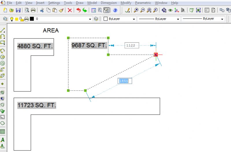

Hefron
Can anyone tell me how can I link block to an area so when I change the size of an area the values in block will update automatically?

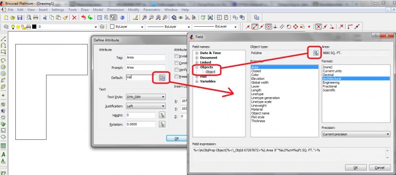

Raggi_Thor
These are the commands you use,
ATTDEF to define the attributes.
This command has the option to use a FIELD as a default value.
In the FIELD dialog, select obect, select your pline, the select Area and formatting if you like.
Then define your block.
The problem is that all instances of this block, every insert, will be linked to that one pline you selected.
I did this in Bricscad, but I bet AutoCAD is practically idential.

Raggi_Thor
If you make one block linked to one object, then copy-paste both the block insert and the object, you have a new link between the two copies.
