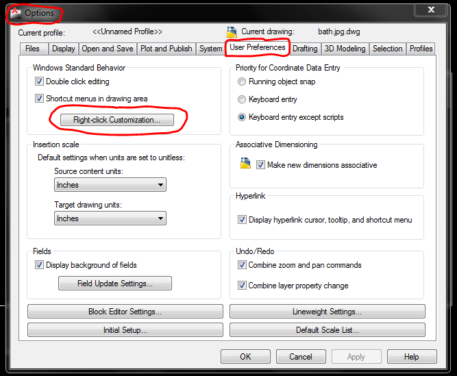

ncasello Posted January 6, 2012 Author Posted January 6, 2012 Version 2010 ... where can I find how to change the right click settings ... I want it to automatically repeat last command. and also where to change the size of the "pick box" ? thanks ! Quote
ReMark Posted January 6, 2012 Posted January 6, 2012 PICKBOX Sets the object selection target height, in pixels. Set it at the command line. Quote

ReMark Posted January 6, 2012 Posted January 6, 2012 Click on the arrow next to the big, red letter "A" in the top left hand corner of your screen. Now look in the bottom right hand corner of the window that comes up. Click on the word Options. Quote

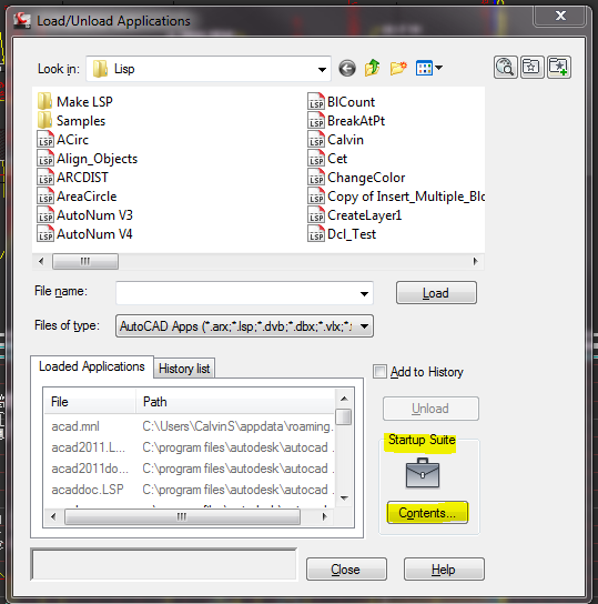

ScribbleJ Posted January 6, 2012 Posted January 6, 2012 Try this out. Here is a lisp routine I wrote that will override the current AutoCad commands. Create just a normal text document and copy and paste the code below into it. Then rename it whatever you want the file name to be and change the file extension to .lsp (i.e. Override.lsp) and then add it to your Startup Suite in your Appload dialog. (See image below.) The code below are the ones I use the most. Some of them are not two letter keyins though. If your wondering what to keyin for each command just use the letters found after defun c; For example defun c:zp would mean you type in zp for zoom previous. You can change to whatever you want. Just change the text after defun c: and leave the rest as is. I hope this helps. (defun c:fd () (command "filedia" "1")) ;;;Toggles on file dialog box for dwg file selection. (defun c:zp () (command "zoom" "previous"));;; (defun c:ze () (command "zoom" "extents"));;; (defun c:za () (command "zoom" "all"));;; (defun c:zw () (command "zoom" "window"));;; (defun c:tm () (command "tilemode" "1")) ;;;Toggles to model space from paper space. (defun c:tp () (command "tilemode" "0")) ;;;Toggles to paper space from model space. (defun c:t2m () (command "txt2mtxt"));;;Changes Dtext to Mtext. (defun c:psm () (command "pagesetup"));;;Opens Pagesetup Manager (defun c:ins0 () (command "insunits" "0"));;;Sets insunits to zero. (Unitless) (defun c:ins2 () (command "insunits" "2"));;;Sets insunits to two. (Feet) (defun c:insds () (command "insunitsdefsource" "0"));;;Sets source content units value (defun c:insdt () (command "insunitsdeftarget" "0"));;;Sets target drawing units value (defun c:ldy () (command "lengthen" "dy"));;;Lengthens a line dynamically (defun c:lde () (command "lengthen" "de"));;;Lengthens a line by delta (defun c:sel () (command "select"));;;Creates a selection set for using "Previous". (defun c:mp () (command "matchprop"));;; Matches properties of selected entity. (defun c:qa () (command "qlattach"));;;Attaches Quick Leader to selected Mtext. (defun c:lc () (command "laymcur"));;;Sets selected layer to current layer. (defun c:mpl () (command "mpolygon"));;;Creates a Map 3D polygon (i.e. color filled polygon. (defun c:lm () (command "laymrg"));;;Layer merge. (defun c:3dp () (command "3dpoly"));;;3D Polyline. (defun c:rvc () (command "revcloud"));;;Revcloud. (defun c:alo () (command "layer" "ON" "*" ""));;;Turns on all layers. (defun c:gmvoff() (command "geomarkervisibility" "0"));;;Turns off geomarker (defun c:gmvon () (command "geomarkervisibility" "1"));;;Turns on geomarker (defun c:mii () (command "mapiinsert")) (defun c:cs () (command "chspace")) (defun c:f0 () (command "fillet" "R" "0"));;;Sets fillet radius to zero (defun c:vr () (command "viewres" "y" "20000")) (defun c:ra () (command "regenauto" "on")) (defun c:xs () (command "xlist"));;;list xref layers (defun c:mw () (command "mapwspace" "on")) (defun c:mbp () (command "mbuttonpan")) (defun c:poi () (command "_pasteorig")) (defun c:ucsv () (command "ucs" "v")) (defun c:ucsw () (command "ucs" "w")) (defun c:osz () (command "osnapz" "1")) (defun c:oszz () (command "osnapz" "0")) Quote

ncasello Posted January 9, 2012 Author Posted January 9, 2012 found options menu ! thanks ..... but typed MENUBAR enter, 1 enter. says no menus are defined ?! Quote
