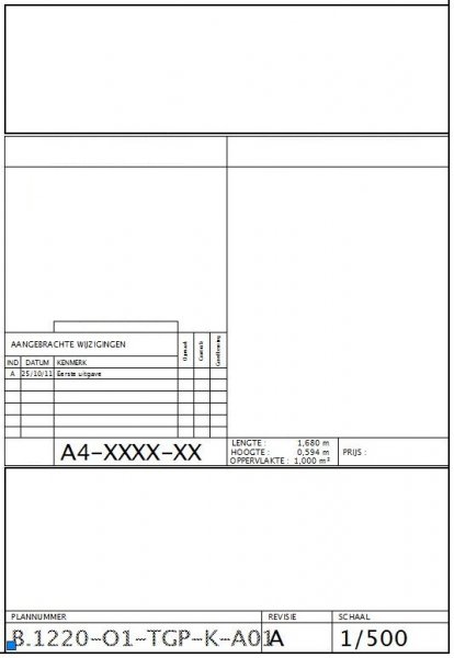

My colleague and myself have a problem with the font Lucida in the header of a plan we designed.
He's running Windows Vista and I am running Windows 7.

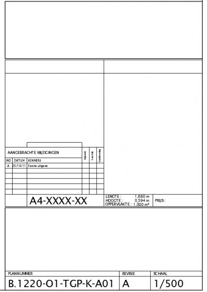

I designed the header, but now he has to make some additional plans with that same header but if he opens the file with that header, strangely enough the font Lucida he uses is not exactly the same as the one I've used although the properties show they're all the same. Another colleague with Windows 7 has no problem with it. As you can see in the attachments I've added, the '1' is not exactly the same as well as the '-' so texts don't fit the boxes they're in anymore.
We also can't really alter the font, seeing as Lucida is the font our client uses and requires for this project.

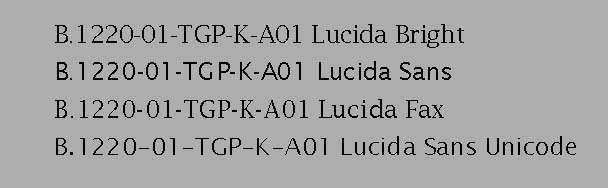

The difference between the two fonts is the one on the left has serifs while the one on the right is sans (without) serifs. Looks like the Lucida Sans Unicode version 5.00 font to me.
To my knowledge "Lucida" is a TrueType font which means it is a Windows font and not an AutoCAD font.

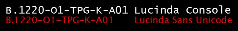

The Vista font is called Lucida Console version 5.00. Vista also shipped with Lucida Sans Unicode version 5.00 as well.
Good news. I just discovered that Windows 7 shipped with both versions of Lucida as well.

The fonts (they are TrueType by the way not SHX) are both from the same family (Lucinda) but they are different in appearance (re: serif vs. sans serif) and the kerning (spacing between letters) is different as well.

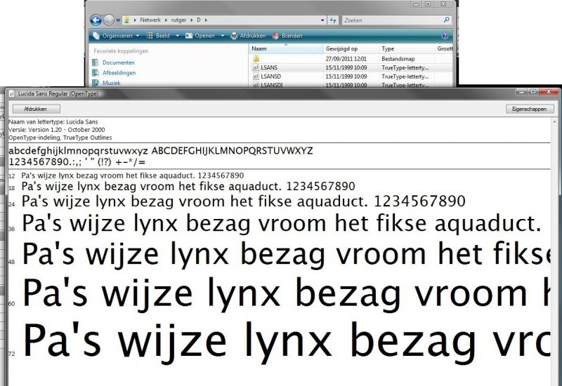

We've definitely established that the font I used to create the header is LSANS.TTF

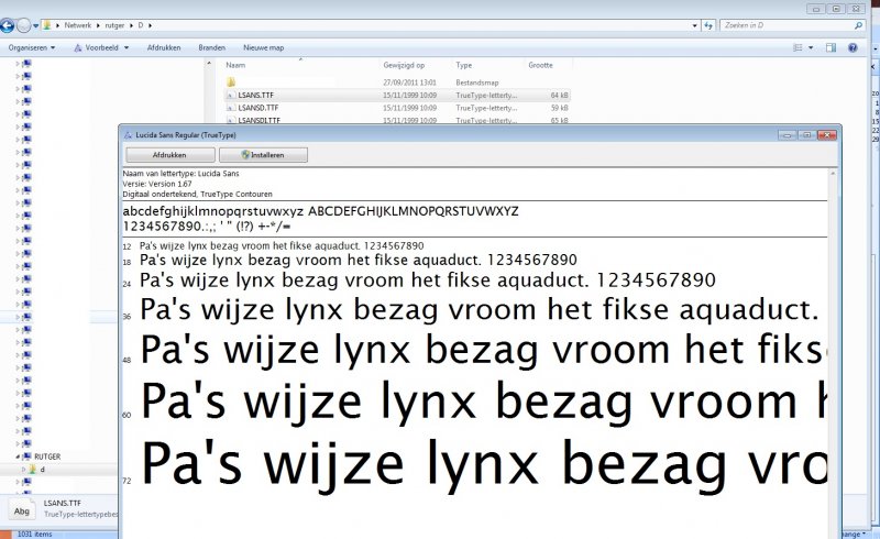

But we're almost certain it's a problem with compatibility between Windows Vista and 7, because I've put the file LSANS.TTF on our internal network and when I open it there it shows it is version 1.67. When my colleague opens the same file on his Vista pc it shows it's version 1.20? With an alternative '1' and '-' So I guess Vista is not compatible with that newer version of the font? See below
So to double check I made a little word file using that same font and mailed it to him, but when he opens it, the fonts again are not the same anymore.
I guess the only solution is for my colleague to upgrade to windows 7, unless someone has another solution?

Looking at the screen images, one font is Open Type and the other is True Type.
