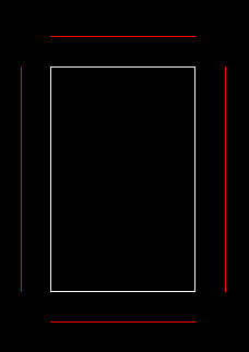

Hi-
This is what I thought of from reading your post. (see picture below) Let me know if I misunderstood you.
This will work on rectangles only. They can be horizontal or rotated.
You need to enter an offset distance and select a rectangle. The routine stays open to allow you to select more than one rectangle. I hope that helps.

I did notice a couple of things that I missed when I posted the code.
The first thing is to update this line:
(vl-cmdf "explode" (entlast) [color=red]""[/color])
You shouldn't need the quote marks at the end of the line. Just delete them. Let me know if that doesn't work for you.
The other thing you could do is add *error* to the local variables
(/ [color=red]*error*[/color] CurLayer OffsetDist VlaObj sset num Ang Ptdist StartPt EndPt)
Otherwise I hope that works for you.
