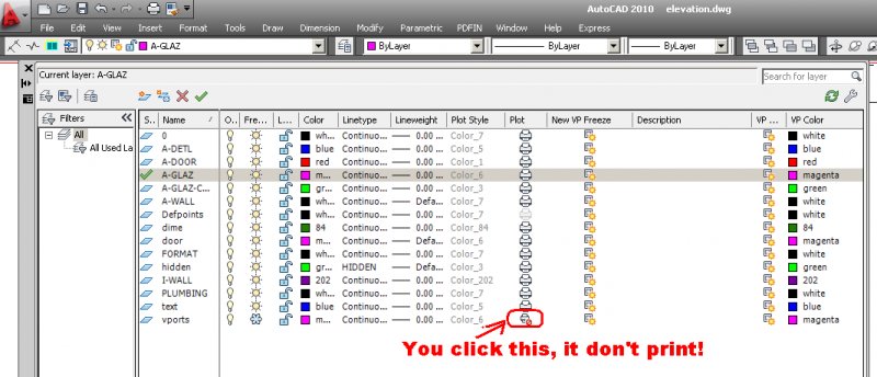

Jack_O'neill Posted February 22, 2012 Posted February 22, 2012 Guys, you're working way harder than you need to. If you have stuff you don't want to show up on paper, you can either put it on defpoints layer (which some people seem to be alergic to), or create a layer named anything you want it to be and click the printer icon indicated in the picture above. Put the stuff you don't want to show up on paper on that layer, and presto...it don't print. Quote
