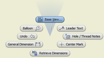

JD Mather Posted August 29, 2012 Share Posted August 29, 2012 ... you might also recall a product that duplicated your digitizer layout translucently across the screen. That had seemed a promising way to go at the time. I wonder if AutoCAD will ever see a Marking Menu - Gesture based commands (experienced users don't even need to wait for the menu - just gesture where the command would be if you waited a bit.) Quote Link to comment Share on other sites More sharing options...
