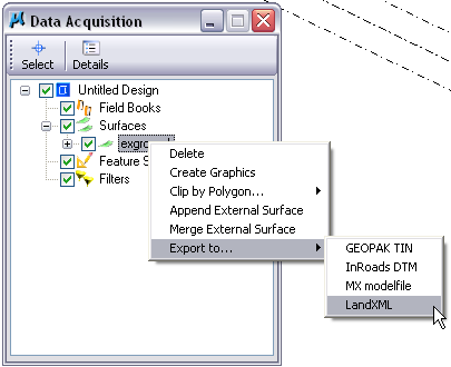

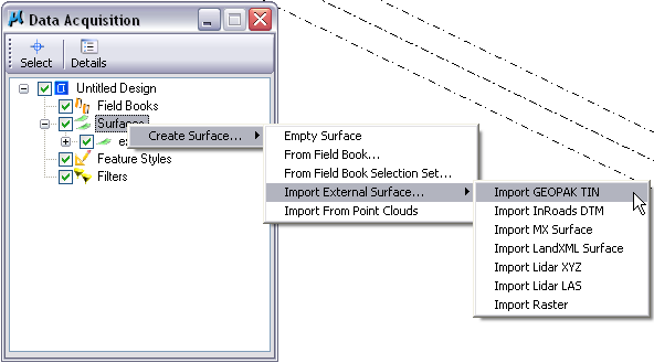

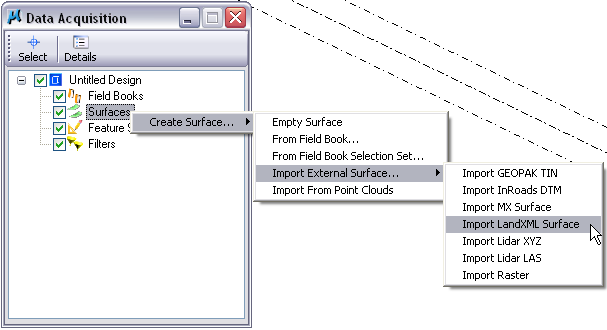

envisioncad
barefootbob, depending what version of MicroStation you have you might have access to the new Data Acquisition tools. This will allow you to import and export multiple surface formats from many platform products.
HTH,
Bob Mecham
