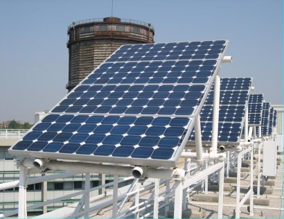

Something square or rectangle area with four circle feet to put in a plan roof.
With not much detail.
Something lije the phot but withou much details.
Thanks.
In that case simply extrude a rectangle for the frame and extrude circles for the tubular supports.

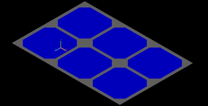

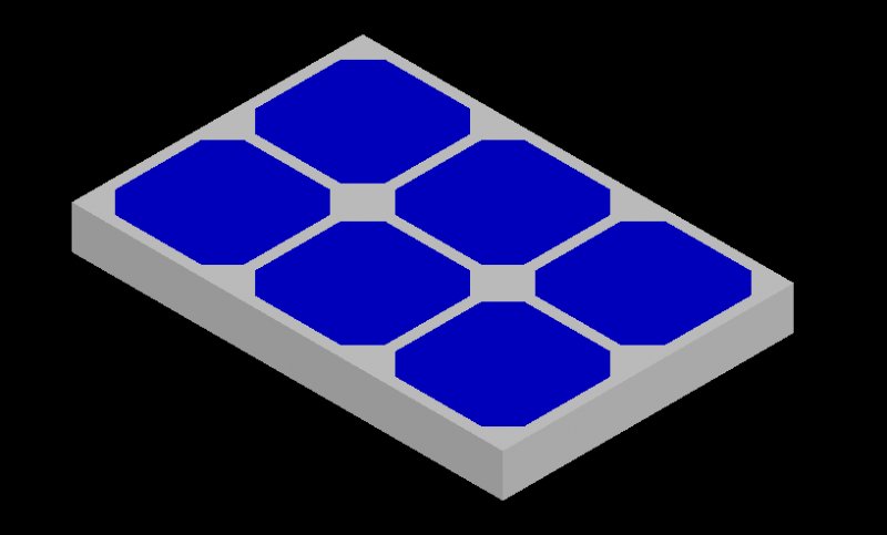

Small solar panel without a lot of detail.
How did you do the blue geometrie?
The blue "wafer" was created using a square with chamfered corners that I extruded a minimal amount. I set the wafer into my frame which was constructed with a void sized to accept the wafer. Make sense?
Surface of panel created using regions.
