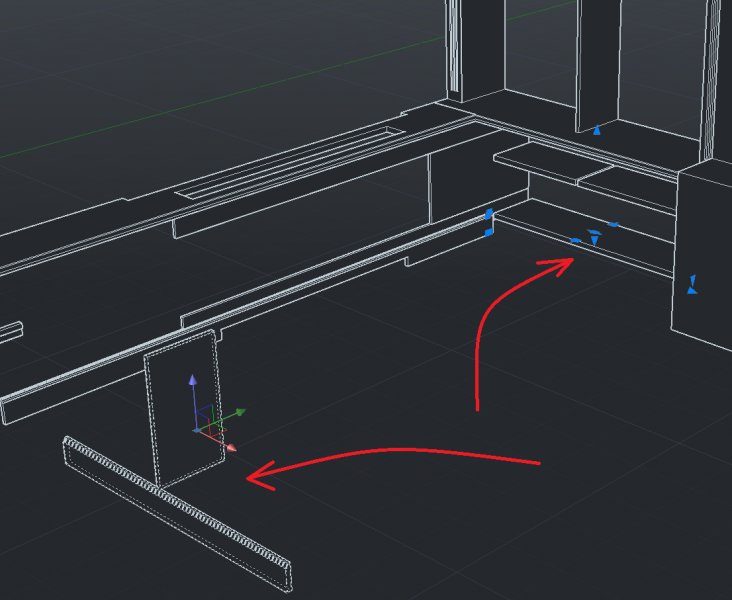

Oppie Posted April 20, 2012 Posted April 20, 2012 This is the third time that the source of my solids are outside the solid Anyone anyone with the same problem? Quote

Oppie Posted April 20, 2012 Author Posted April 20, 2012 When I select the 2 solids on the left bottom, mij grips appear on the upper right as you can see in the printscreen. But where the grips are in the printscreen that is the place where the solids should be. But when I reopened the drawing this morning they where on the left bottom While the origin was still at the right place Quote

Oppie Posted April 20, 2012 Author Posted April 20, 2012 While I'm on the forum and opening my file again the drawing is almost finished, it looks like the solids jump to another place again. To me it's obvious there's a bug in the Solids Quote
ReMark Posted April 20, 2012 Posted April 20, 2012 OK...I thought you were talking about the grips not the solids themselves. You're saying that you placed some trim pieces and after saving, closing then reopening the drawing the pieces are in a different location? Quote
Oppie Posted April 20, 2012 Author Posted April 20, 2012 OK...I thought you were talking about the grips not the solids themselves. You're saying that you placed some trim pieces and after saving, closing then reopening the drawing the pieces are in a different location? Yep that's the case, and when I slect theme on that different location, I see the grips at the original place Quote

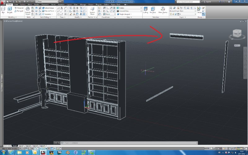

Oppie Posted April 20, 2012 Author Posted April 20, 2012 I have a video: when zooming in the solids move http://youtu.be/mn1E2f6oE7c Weekend starts here! CU later Quote

dedmin Posted April 20, 2012 Posted April 20, 2012 While I'm on the forum and opening my file again the drawing is almost finished, it looks like the solids jump to another place again. To me it's obvious there's a bug in the Solids [ATTACH=CONFIG]34319[/ATTACH] Yes, I see that too here - seems a bug to me! Quote
Oppie Posted April 20, 2012 Author Posted April 20, 2012 That's not fair. If I'm helping you with a problem you have to stay until I give up. Not you. LoL OK...well have a good weekend. Maybe your version of AutoCAD will self-correct after it takes a rest. logged in @home now, but have you seen the video? Quote
