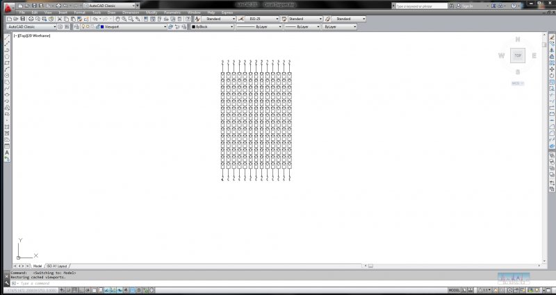

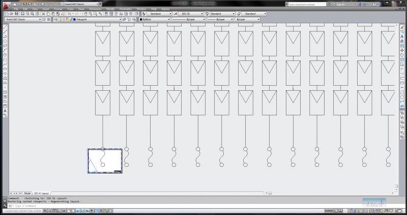

Hello MSasu. Yes, I would like to perform my drawing on an A4 Size Paper and print on an A4 paper. If possible, can you teach me how to add texts and get AutoCAD to draw appropriate unit?
I am simply drawing basic electronic circuit diagram which are solar cells represented by rectangles and alike. I am very sure my kind of stuff is kindergarten work for you expert. :lol:
I drew it up anyway, but once again it doesn't match the paper size... So if you may allow me to update my questions I have:
1. Unit confusion. I am not sure what unit is AutoCAD outputting
2. I do not know how to add texts. I would love to.
3. I do cannot understand why my plans cannot fit in the paper. So I have paper sizing problem.
4. When doing a print test, the words are very very blurry cause I think the text are compress from A1 to A4...
Attachments of what I would like to seek help are expressed in the attachments. Please refer to them to see a clearer image of what I am experiencing.

ReMark
One unit can be whatever you want it to be. 1 unit = 1mm, or 1cm, or 1m, etc.
Text can be done in either model space or in your paper space layout. If you are going to leave it in model space then you might want to look into using a feature called Annotative Scaling.
Paper size can be changed by going through the Page Setup manager accessed via right-clicking on a Layout tab then selecting Modify at the next dialog window.
There can be several reasons for blurry text one of which is the size of the text and the lineweight it is printed with. Without a copy of your drawing it is difficult to pinpoint the exact cause.

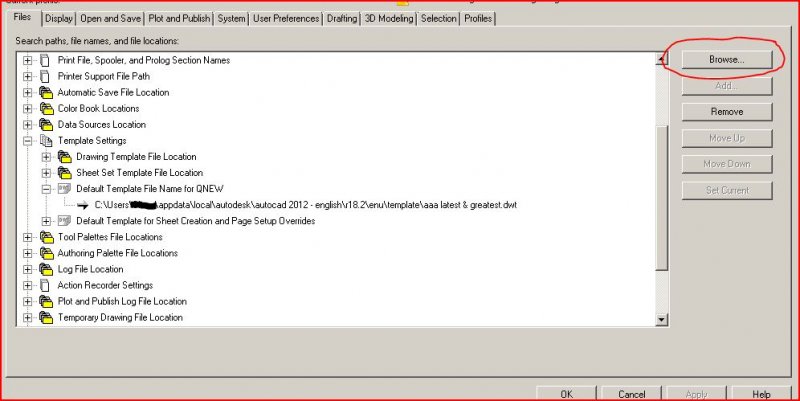

Dadgad
You can specify which of the many available templates (.dwt files) you wish to set as your preferred template for the QNEW button.
I am guessing that you would want a METRIC one, probably ending in ISO.
Should you choose an IMPERIAL based template you will not be able to change that inherent dimensional bias later.
Share this post
Link to post

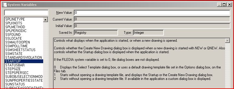

Dadgad
As regards starting with a blank screen, you should consider these different available options for the STARTUP system variable.
Share this post
Link to post
