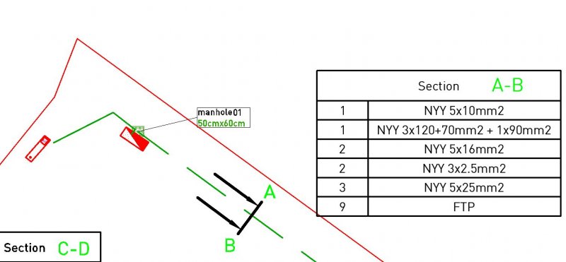

Michalis Posted May 15, 2012 Posted May 15, 2012 Hello everyone, im a new guy here and i need some help, I want to draw a line, (its kind of Section) and then should generate a table with polylines or lines Layer with Count, that pass through, i've done that with Mechanical using Section and with dx, but i need it faster with lisp, i could use table, or block so when i insert it should need first point, then 2nd point and would give me all layer names in a box with count, forgive me for my english, please see image below Quote
Tharwat Posted May 15, 2012 Posted May 15, 2012 Welcome to Cadtutor   What is the section is about ? and what is it consist of ?  And it would much more clearer for all if you show the table in English language  Can you upload a drawing of that section ? Quote

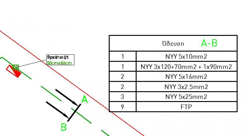

Michalis Posted May 15, 2012 Author Posted May 15, 2012 you are right, this is a new Screenshot translated in English, the story goes like this, im using Layer name for each cable that i use, for instance, NYY 5x10mm2 is the Layer name and the NYY 5x10mm2 also, from A-B according to my draw, i have many cables, 9FTP Cat5 1NYY 5x10, 1NYY 3x120+70 + 1x90mm2 2NYY 5x16 etc etc, so, i want to select 2points (A-B) for instance, the 2nd image show all the lines that pass through 2points (model space), so now i have to work this from manhole to manhole to illustrate to the guys at the work site and inform them how the piping will be done, Â the section is a simple polyline, crossing the other polylines, Â Quote

Michalis Posted May 16, 2012 Author Posted May 16, 2012 Dear friends, lets make it harder  it should be great when i use the code for 2nd time, the A-B to be done C-E and then F-G etc..etc.. Also, the 2 points that i specify should leave me a polyline and a name above them with the Section Name, for example if i run it first time, i Specify 1st point, then 2nd point, the result should be, A polyline From 1st point to 2nd Point with A-B letters above each point, and the table is great as it is, Then, when i should run it for 2nd time, i would specify again 1st point then 2nd point and the result sould be: A polyline from 1st point to 2nd point with C-D letters above, i dont know if its possible for the Arrows to be done, at the Line where the Points where selected at the beginning of the process (1st point 2nd point for each time i run the lsp)  im sure its piece of cake for you guys Quote
