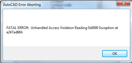

Never tested this idea but no reactors etc... but for poops and giggles see if you can purge layer 1 and layer 2 from drawing.

Opening this drawing just repeatedly causes a fatal error (attached), Jeff.
That worked pretty well Jeff. :thumbsup:
Using 2012 I was able to open it without issue.

I got it, but figured better not to post it, and spoil the fun for others. :beer:
[ATTACH=CONFIG]35046[/ATTACH]
Not sure if it matters, but I'm using AutoCAD 2013 (ADN License), ObjectARX 2011-2013 installed, Visual Studio 2010 Express, and 11 Beta installed (.NET Frameworks 4.0, 4.5 Beta) in case you've nested a .NET object in the database. Windows 7 Ultimate x64 (MSDN License).
