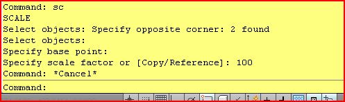

Dadgad Posted May 28, 2012 Share Posted May 28, 2012 Thank you. How would I actually do that? Do I need to select scale in Modify and then?[/quote Welcome to the forum. Start by entering SC at the commandline, then follow the instructions at the commandline. The image shows the series of steps needed to do it. Quote Link to comment Share on other sites More sharing options...
Tiger Posted May 28, 2012 Share Posted May 28, 2012 Look at the commandline at the bottom of the screen, that is where AutoCAD will tell you what it wants from you. Hint: it should say Select Objects: Quote Link to comment Share on other sites More sharing options...
