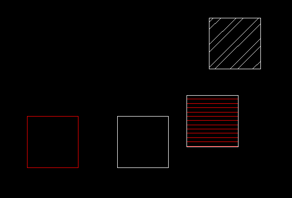

Taken from your drawing after changing the value of FILLMODE.

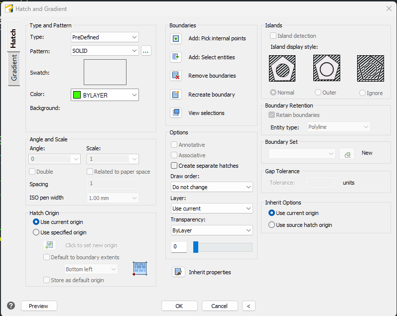

does Your Hatch setting look like mine? This is how i do solid hatches...sometimes i do get "ghost hatches", when i copy them from another drawing. Then i restart CAD and then they show up...hope this helpsSnimkazaslona2025-02-28125239.png.247b924a9848c8ab1fbf3cd8da3a302a.png
