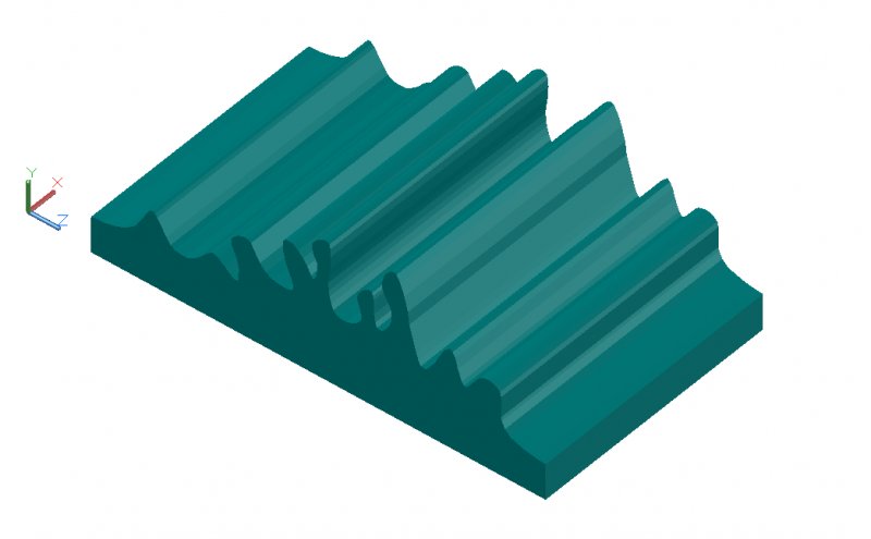

ReMark Posted June 7, 2012 Share Posted June 7, 2012 (edited) Can we see the sculpture in 3D please? There has to be more to it than that. Is this the final form it will take? Edited June 7, 2012 by ReMark Quote Link to comment Share on other sites More sharing options...

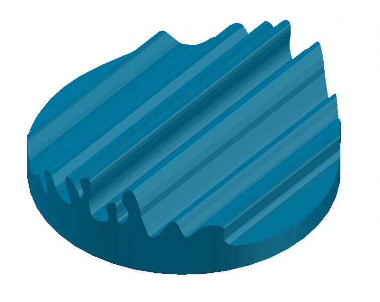

ReMark Posted June 7, 2012 Share Posted June 7, 2012 Or maybe something like this: Quote Link to comment Share on other sites More sharing options...
ReMark Posted June 7, 2012 Share Posted June 7, 2012 Re: Dimensioning. What is the spacing on your grid equal to? 6"? 12"? Other? Quote Link to comment Share on other sites More sharing options...

Rienei Posted June 8, 2012 Author Share Posted June 8, 2012 Hi, sorry for the late reply. @remark : the sculpture is just a basic piece just like the first picture you have provided. Thanks for all the replies i will look into how i would do ordinate dimensions Quote Link to comment Share on other sites More sharing options...
