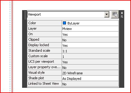

I am using AutoCAD 2010.
Recently there are commands that I have used in the past but now are not able to attain through mouse clicking.
I used to be able to right click on a viewport and a dialogue box would come up which had a feature allowing me to unlock that particular viewport. Now all I get is a standard dialogue box with copy,cut and paste,etc. I tried to go to the help section and find a command I could type in for unlocking the viewports and was not successful in finding that info! I need this info today (June 18, 2012)!

Re: unlocking viewport. This can be accomplished via the Properties palette and/or Quick Properties too.

OMG! Thank you for the properties palette solution!

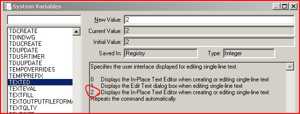

Sounds like you want to set your TEXTED system variable to 2, check in the image for available options.

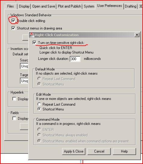

You may also be looking for TIME SENSITIVE right click settings which you can find in your OPTIONS on the USER PREFERENCES tab. If you haven't tried it before you might want to.

I also cannot find an icon for "quick properties" ...I have one for regular properties and thank you for the "display locked" solution.

"TEXTED" is not in the AutoCAD 2010 version of the system variable

I don't know if you saw my edit to POST #8, regarding the RIGHT CLICK CUSTOMIZATION options. :)
Dadgad meant MTEXTED. Try again.

yes, I put a check mark in the "time sensitive" box of the right click customization as you showed me and now when I right click the "options" dialogue box comes up!

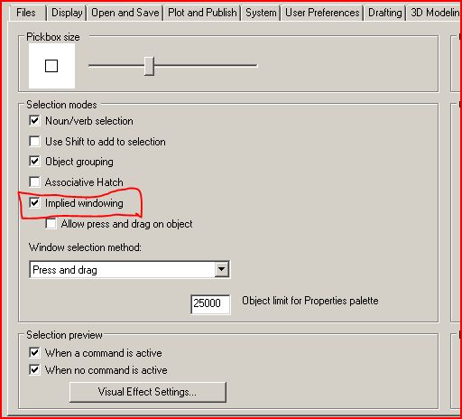

Check the image please. Might this be what you are after?
