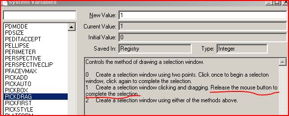

Dadgad
Try PICKDRAG, check the image. I hate having to click twice, as in the 0 setting.

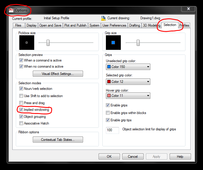

ReMark
The options dialogue box is different in version 2010...there is no "implied windows" option
Would I be able to turn that on via a command?
Take off the sunglasses. Screenshot taken from AutoCAD 2010.

Catcall
I set PICKDRAG to value "1" but still didn't help clicking issues!

Catcall
OK, sunglasses off......the implied windowing IS checked and WAS checked!

Dadgad
Where's that beer you were toasting?!
We already finished the beer.
So just turn on your implied windowing, as ReMark believes that it is an available option in 2010, and he is usually right! :beer:
