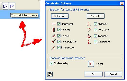

JD Mather Posted November 4, 2008 Share Posted November 4, 2008 how to i fix my snap? Have you been fooling with Constraint Persistance or Constraint Options? Quote Link to comment Share on other sites More sharing options...
