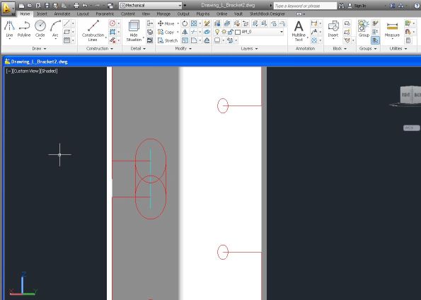

It seems I can't put a double line between the two circles to create a slot.
Instead, I have drawn a symetrical line.
Selecting the two centre points inside the two circles, then draw a line on the left side were the red helpline crosses the outerline of the circle.
This will create a drawing like in the picture below:

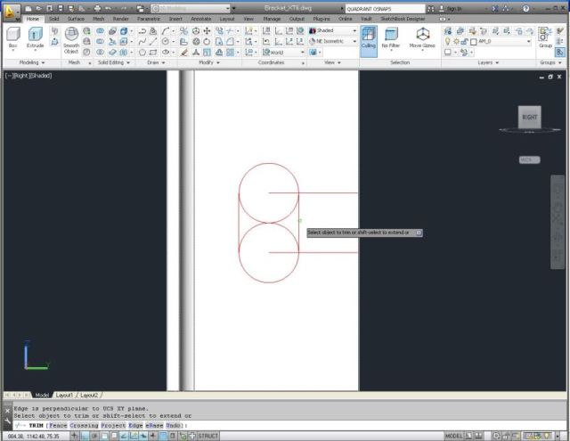

My try to get the TRIM command working:
While in 3D Modeling area (meaning the tab at the top-left corner)
I click on the TRIM command.
The statusbar shows the message:"TRIM Select objects or
When I try to select something, I think I get an errormessage stating:
"Object is Perpendicular to UCS XY plane."
Click on your view cube such that the view is oriented parallel to the screen.
You should be looking at your "sketch" as though everything is 2D - as this geometry that you are working on is 2D at this point.
BTW - you don't really need to trim the arcs.
You could simply presspull 3 times to remove the 3 areas of the slot.

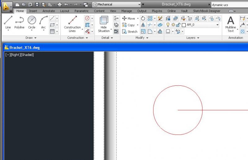

Ok, I think I've got this one!
It's the box just at the leftside of the drop-down window like in the picture below? (Not the drop-down menu itselves!):

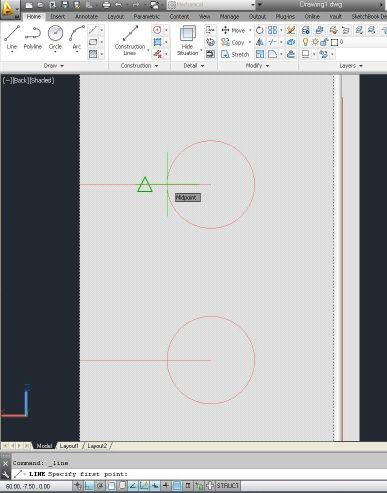

When I draw to circles and want to add a line to create a slot, I get the following:
When I click to draw the line, the line isn't were I want him to be.
Instead of on the place were the cross centre is, the line is placed at the green triangle...

Ok, Ive right-clicked on the Object Snap icon at the bottom, and in the menu that appears I've selected the Quadrant...
But it seemds like there is no difference...
Sometimes AutoCAD will not acquire Quadrant Osnaps if the circle is not on the same plane as the current UCS. When this happens, just type "Quad" to force AutoCAD to use the Quadrant Osnap.
Thanks for this solution, this works great!
