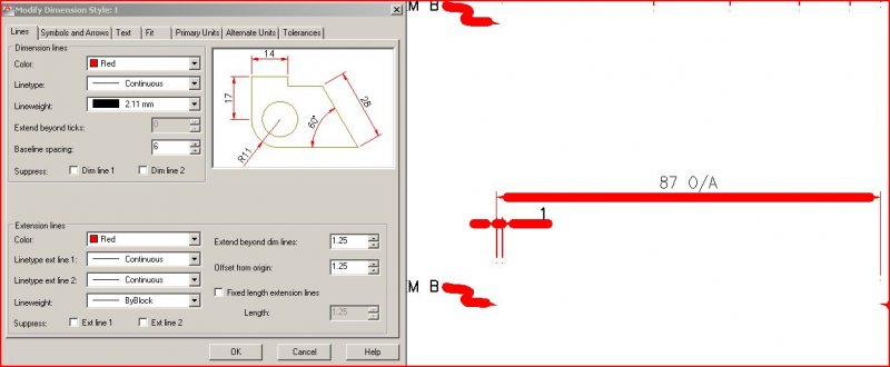

I'm wondering how to change the thickness of leader lines. I'm editing a drawing done by someone else and I need to make the leader lines thicker. I tried changing the layer thickness and making sure the settings were such that the leader line thickness would be determined by the layer. I also tried channging the leader line thickness in properties and/or leader styles, but no luck there either. Anyone know what might be going on?

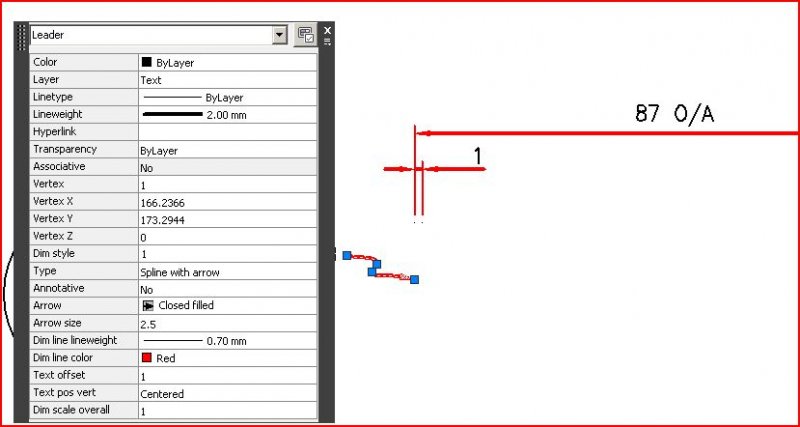

Leader lines are part of the DIMENSION style.
In order for them to have displayed as shown I have turned on SHOW LINEWEIGHTS, the better to understand what is happening. :)

Dadgad
Now you understand that they can, just remember that they share the lineweight with dimension lineweights. :)
