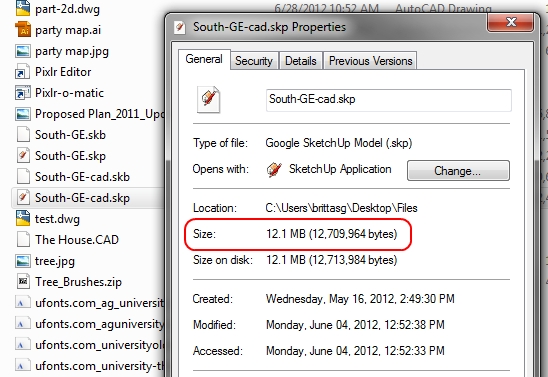

f700es Posted July 12, 2012 Share Posted July 12, 2012 How big is the SU file, sorry not the XML file Quote Link to comment Share on other sites More sharing options...

f700es Posted July 12, 2012 Share Posted July 12, 2012 Where would i find the SU detail? You right-click on the file and select properties.... Quote Link to comment Share on other sites More sharing options...

geekgirl Posted July 12, 2012 Author Share Posted July 12, 2012 the file is 46.9 MB (49,261,468 bytes) Quote Link to comment Share on other sites More sharing options...
