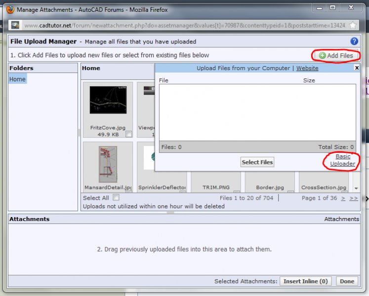

iainlines Posted July 16, 2012 Posted July 16, 2012 Hi, I have a very simple 3D model which I would like to produce some manufacturing drawings for. Not being that great at this I wanted to use FLATSHOT, insert the blocks and then cut and paste them into paperspace. All sounds pretty simple. Thing is I have inserted the ISO view shot fine but when I come to do top and front I still get the isometric. I have made the differing viewports curret for each time I use the command but is doesn't seem to be working. Anyone care to take a look and point out what I have missed? Thanks Iain Great, I can't drag and drop the file in the file upload manager!!! Quote
ReMark Posted July 16, 2012 Posted July 16, 2012 Try clicking on the Add Files button (with green cross). I've had similar problems with the upload manager too. Quote

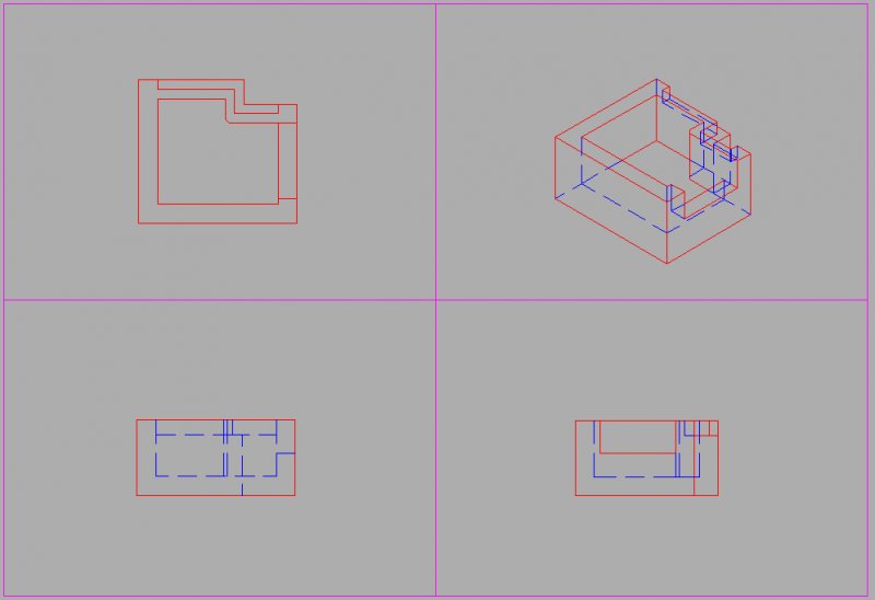

ReMark Posted July 16, 2012 Posted July 16, 2012 A quick four panel layout with my four views. Scale: 1:4. I would strongly recommend that you create a separate layer for any viewports (set to "no print") as well as for any 2D objects (such as blocks) created with Flatshot. Quote

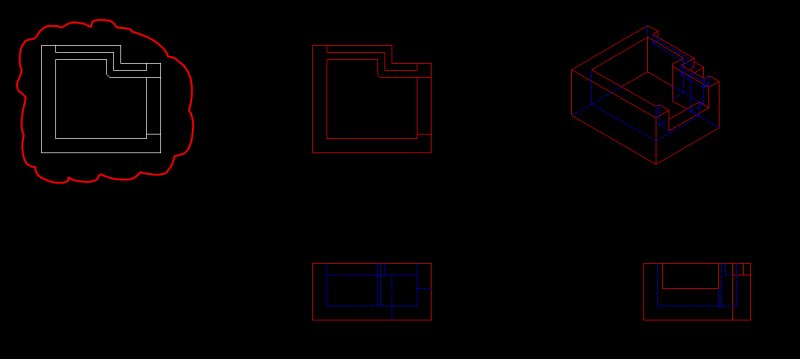

ReMark Posted July 16, 2012 Posted July 16, 2012 Let's try to remain calm. There is nothing wrong with the way the command operates; it is your technique that is probably at the root of the problem. How did I produce mine? Simple. I created all four views in model space. I made sure that for the top, front and side views that my UCS was in the proper orientation relative to the view I was looking to create. Then I switched to an isometric view and rotated and moved the blocks created by Flatshot as required. I then switched to my paper space layout and used the MVIEW command (set up 4 views and used the FIT option). But...before I did any of the above I created two new layers. One was for my viewports and the other for my 2D objects. Note that you can still have your 3D model and all of your Flatshot blocks in model space as it really does not create any problems. I do it all the time. Quote
ReMark Posted July 16, 2012 Posted July 16, 2012 Model space. Your 3D model, in white, is in the upper left hand corner. Quote

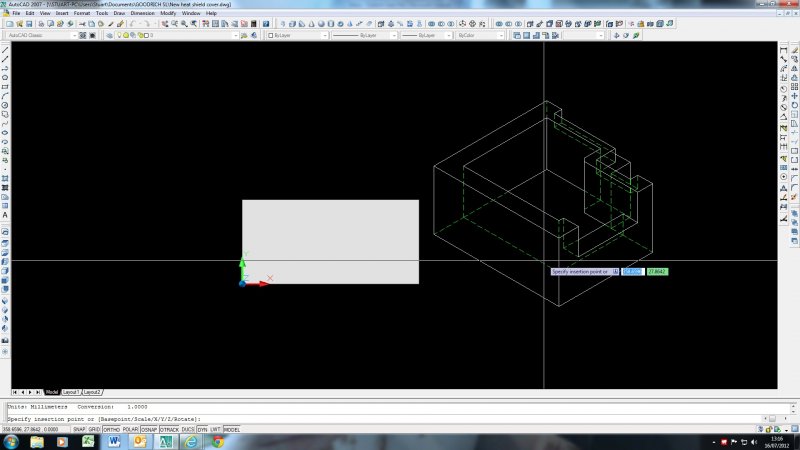

iainlines Posted July 16, 2012 Author Posted July 16, 2012 Attached a jpeg. See what you think folks. I do appreciate the help Quote

nestly Posted July 16, 2012 Posted July 16, 2012 I did the video with Camtasia Studio, but there is a free version called Jing that takes screencaps and videos of your screen. http://www.techsmith.com/jing-features.html The block should be a projection of the current view onto the current UCS. If your screenshot above is taken while the FLATSHOT command is still active, then there's something going on that I don't understand. When you run FLATSHOT, is the destination set to "insert as new block" Quote
iainlines Posted July 16, 2012 Author Posted July 16, 2012 Nestly, yes it is but here's another one for you. I just had another quick try and decided I didn't want to show hidden detail, or obscured lines as Acad says so I un-checked the box. Guess what? They're there anyway. Wonderful Tried to download Jing but anti virus software said no!! Quote
