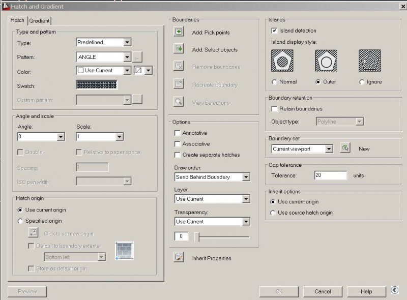

If you use the HATCH command instead to CREATE a new hatch in an area where there is no hatch,
you can use the INHERIT PROPERTIES button in the hatch dialogue box, as shown in the image.

The HATCH & GRADIENT DIALOGUE BOX has gotten a lot better in the last few years. If you expand all of the flyout menus, like in the image,
you can see that there are a great many ways in which the HATCH which you are creating can be customized to suit.
Typically when you create a new hatch, the default is to create it on the current layer, but you can override that default
in the OPTIONS sections in the center of the dialogue box.
One nice advance is the ability to set your HALOGAP here, which fills small gaps in the perimeter of a hatch definition, so if
you have holes in the defining geometry, it won't get kicked back, but rather accommodated, if the gaps are smaller than the
HATCH ALLOWABLE GAP (gap tolerance) which you have defined in the dialog box.
