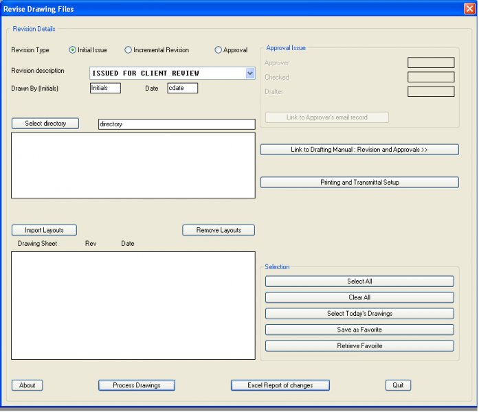

Matt_Just Posted August 6, 2012 Share Posted August 6, 2012 Hi all ... Not new to v/lisp, but new to this great forum. I'm looking to automate title block revision, pdf generation and transmittals via lisp (which will probably be later converted to VB). My question is: Is it possible to create pdf's via script that will assign filenames [which I will extract from the drawings] ? from what I have managed to ascertain this is achievable. 1) by a 3rd party pdf application (which I'm not against, but I would just prefer an all-in-one custom solution to save on portability/deployment issues) 2) by editing a registry entry (not keen on this, hopefully avoidable) to be passed to the pdf driver. If someone suggests using publisher, I have limitations using it - particularly in regard to assigning the file name exactly as I want it, and without a dialog. Have had no luck using the DWG to PDF.pc3 supplied by AutoDesk either. Quote Link to comment Share on other sites More sharing options...

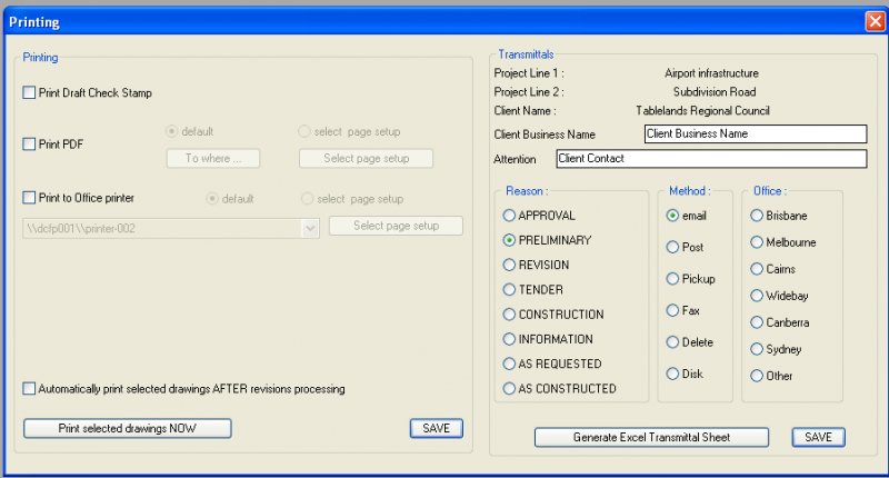

Matt_Just Posted August 10, 2012 Author Share Posted August 10, 2012 Hi BigAl - thanks, I got a chance to read that this morning This is what I have in the works features are : Selection - essentially a viewer (which is why this may need to be VB coded) that allows multiple selections from multiple directories. Auto Revision of title blocks using 1st, incremental or approved type Autoprinting batch sets - to local printer/pdf or even file etransmit generation (pdf's autonamed to titleblock contents) Auto Transmittals - we have document reciepting that's a bit old-skool (just excel sheets, no db's) I've nearly done the dcl's and coding for the printing & transmittal generation, but don't have a full generic revision function for variable revision increments as yet. Quote Link to comment Share on other sites More sharing options...
nod684 Posted August 10, 2012 Share Posted August 10, 2012 Hi BigAl - thanks, I got a chance to read that this morning This is what I have in the works features are : Selection - essentially a viewer (which is why this may need to be VB coded) that allows multiple selections from multiple directories. Auto Revision of title blocks using 1st, incremental or approved type Autoprinting batch sets - to local printer/pdf or even file etransmit generation (pdf's autonamed to titleblock contents) Auto Transmittals - we have document reciepting that's a bit old-skool (just excel sheets, no db's) I've nearly done the dcl's and coding for the printing & transmittal generation, but don't have a full generic revision function for variable revision increments as yet. [ATTACH=CONFIG]36463[/ATTACH] [ATTACH=CONFIG]36467[/ATTACH] :o:o this is really nice!!! you guys are a real geniuses! Quote Link to comment Share on other sites More sharing options...
