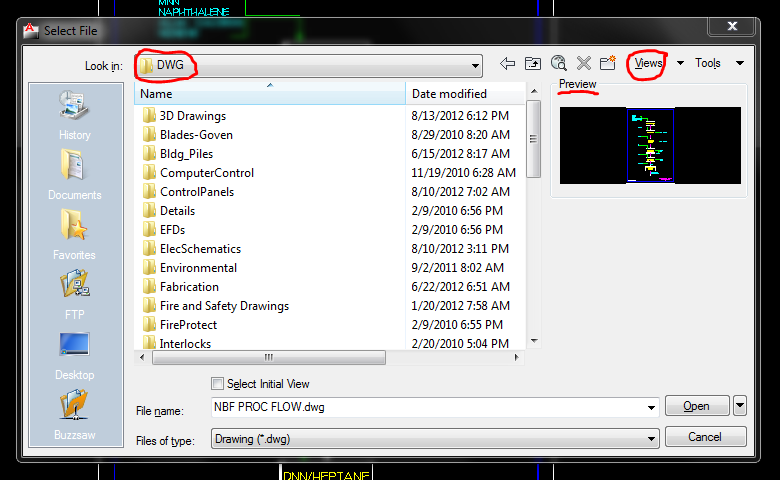

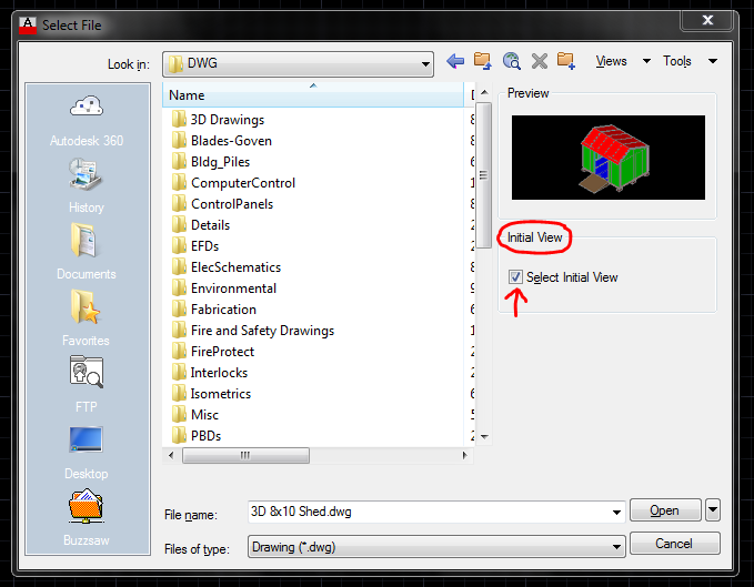

Look at the image in post#8 taken directly from AutoCAD 2013.

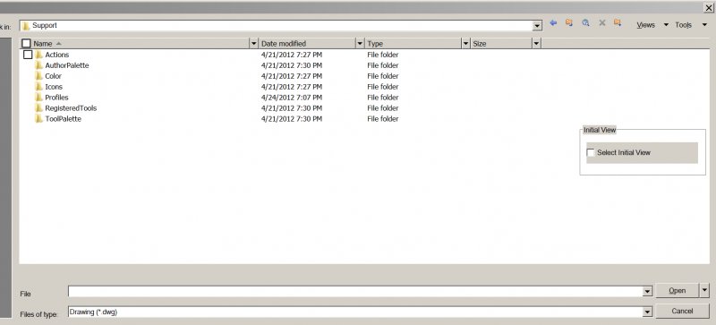

Well great, Yes I can see "select initial view" and the box gowever it is greyed out and inactive, that is why I am looking for the right command.
Mine has been available from day 1 and I can't seem to forcibly turn it off. How did you manage that trick?

I use Mech 2013 and it is broken here as well. The check box does show but not in a place that can be selected.
I believe this is a reported bug with 2013 and seems to be profile related. SP 1 has been released for AutoCAD 2013 now, but no word on if this was fixed.
