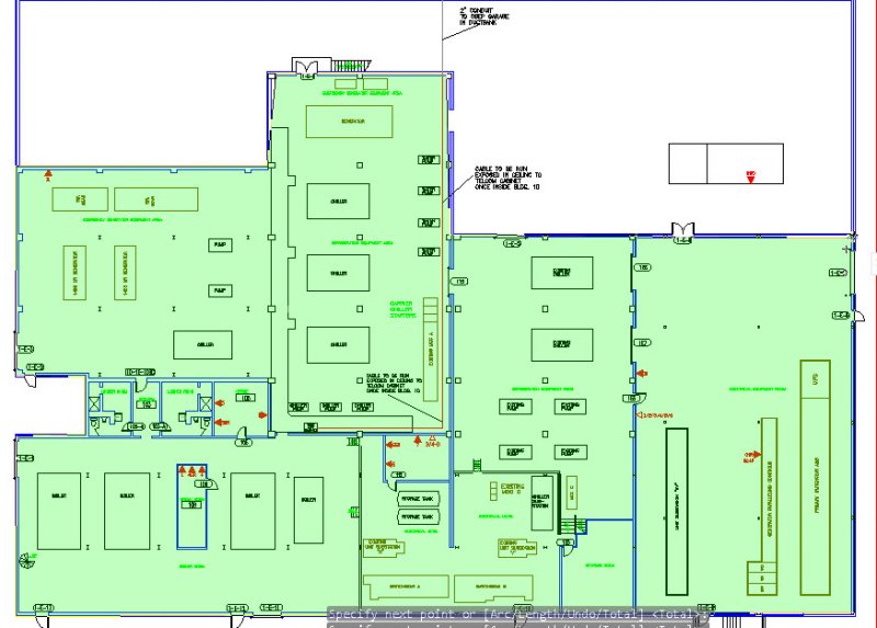

I've figured some things out, but am struggling with what appears to be a very valuable tool... the area tool.
I found many references to the boundary tool, but that looks more complicated.
I have figured out how to mark the corner and press enter, but the output is for example 1.7 sq ft vs. what should be approx 35K sq ft.
I tried to change the units, but that didn't seem to make a difference.
Please help.

Did you create a closed polyline (PE or Join)?
When you type the Area command do you get an option on the command line for Object?
aa
o
click boundary
Since i'm not using the boundary tool, i'm not selecting PE or join, but i guess you could say i'm joining as it's a graphical "fill" off all the area until i get to the end.
at the end, my option is "enter", which i guess equates to "Total".

Sounds like you are doing this in a layout, toggle over to model space and try again. Might be better to draw a pline around the perimeter and then use Area or Field. If things change or you notice you missed a corner you can adjust and list the pline, if you miss with Area you have to start over again. Place the pline on its own layer for future use, etc.

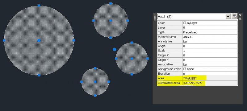

Another way to go is to use your QUICK PROPERTIES display, like this.
rkent is no doubt correct, you need to go into MODELSPACE and try again.
Just guessing, but I assume that the graphic fill which you describe is generally
called a HATCH in Autocad parlance.

attach your dwg file here and indicate the area you are trying to measure. (don't need that whole thing to do a test of the area command)
Are you sure AC lt has that feature? i've been trying to work in the model space, (model tab), but i don't see a mechanism which matches your screen shot above.

Awesome! Thank you guys! It finally worked! Sometimes it takes a while to "see the light"
i wasn't interpreting what you were saying properly. I had to go to the Model tab and then do the area measure tool. Once i did, the true square footage was represented.
