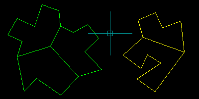

HELP needed with Autocad lisp!!!
ruso
I am in a hurry with the project so I don't have time to write this lisp myself specially couse I don't have any experience in it, so if anyone can help that would be great. Anyway I have a lot of parcels drawn in autocad and what i need to do is trim all the polyline endings and intersections and insert a point in the middle. Manually I do it this way:
- first i make circles (radius has to be 0.5) on the endings and intersections of polylines
- then I trim all the lines inside the circles
- then I insert a point in the center of circles and at the end delete circles.
There is also a picture at the bottom showing the first and the last fase of the process.
If anyone knows about the lisp that does that or maybe have time to write one it would help me a lot.
Thanks in advance. :-)cadtutor1.jpg

Would it be possible to get the same affect if you created a block of a point and used a mask to block the ends of the lines? This block could then be inserted at each intersection.
In the future, to avoid a panic, it is best to seek an answer to a problem before you are on the threshold of your deadline. Just some friendly advice. No offense meant.
Sorry for a delay on answer. Didn't have internet. There are many intersections and I have to do the sam thing on all polyline endings so the number is big. That's why I asked is there a way to insert them automatically to save time. Anyways I know how to make a block but I don't understand how to make a block containing a whipeout?!
If you put in your thread title "Willing to Pay" you might get a better response. :)
Or be patient... people are definitely generous but hope you can get someone to do something for you in time.
Good idea but I think I'm gonna wait a little more! :-)

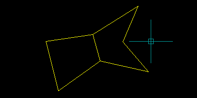

Here is some hastily written code, but should perform as required:

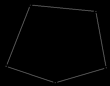

Another .... :)
(defun c:Test (/ ang i in e j p p1 p2 p3 p4 pts sn ss)
Thank you very much Lee Mac, you are a genious. I'm not big on money at the moment but i will make a small contribution to you website. Thanks ones again! :-)
Thank you Tharwat for your time. An error occurs when I try to use your lisp "error: no function definition: VLAX-CURVE-GETENDPARAM". A you can se by my reply to lee mac his lisp works so you can compare and see where is the problem. Anyways thanks.

Many thanks ruso!
I'm glad that my code performs as required and I appreciate your contribution!
Just add (vl-load-com) to the routine and try agian .
Where in the routine? At the beginning at the end... ? I guess i should know that but like I said no experience what so ever so be patient with me! :-)
Just type (vl-load-com) before you execute routine, or add it as first or last line whatsoever if you load it as *.lsp - it will load and that line too as also the rest of the code - main routine body (defun c:functionname (... / ... ) )
