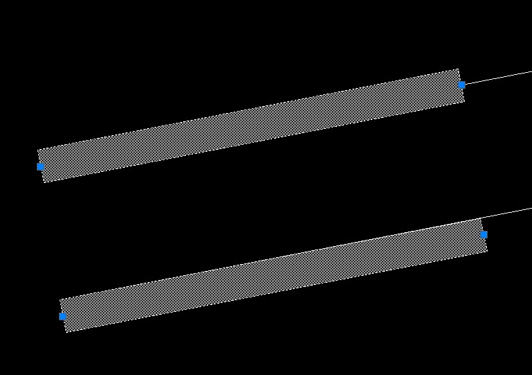

teknomatika Posted October 10, 2012 Posted October 10, 2012 Here is an example to automatically set the options of the offset command to erase the original object and offset to the current layer:Â (defun c:myoffset ( ) (command "_.offset" "_E" "_Y" "_L" "_C") (while (< 0 (getvar 'cmdactive)) (command "\\")) (princ) ) Using the existing options of the offset command avoids the need to reinvent the wheel for this task. Additional code could very easily be added to set/reset the current layer before and after the offset command is called to offset to a layer of your choice. Â Lee, Â Taking this idea, how do I apply to so that a polyline with thickness I can do an offset to half the value of the variable plinewid? I do not know another way to make a polyline with thickness can be drawn without being the center, so this would be an opportunity to do so. To better understand, I attached a picture. Â (defun c:ofpw (/ pw ) (setq pw (/(getvar "plinewid") 2)) (setq pw (/ pw 2)) (command "_.offset" pw "_E" "_Y" "_L" "_C");; not work (while (< 0 (getvar 'cmdactive)) (command "\\")) (princ) ) Quote
Baber62 Posted October 10, 2012 Author Posted October 10, 2012 Hi teknomatika, Â I have another code which I use to adjust various polylines to thickness, but your idea if developed further could prove useful i.e have an offset then adjust the thickness of the line. Perhaps someone might combine the codes together. Â (Defun c:Plw (/ s ss sn i) (if (setq s (ssadd) ss (ssget "_x" '((0 . "*POLYLINE") (8 . "Estate - AAT,Estate - Hatched area,Estate - Lockable gate, Estate - SYL"))) ;<<<<< Enter layer names separated by comma ) (progn (repeat (setq i (sslength ss)) (setq sn (ssname ss (setq i (1- i)))) (if (not (eq (cdr (assoc 100 (reverse (entget sn)))) "AcDb3dPolyline" ) ) (ssadd sn s) ) ) (if (> (sslength s) 0) (command "_.pedit" "_m" s "" "w" 0.2 "") ) ;(princ "\n .... ") ;(princ (strcat "Number of Polylines changed : " " < " ;(itoa (sslength s)) " > " ; ) ; ) ) ;(princ "\n Couldn't find any 2D polyline !!") ) (princ) ) Quote
Lee Mac Posted October 10, 2012 Posted October 10, 2012 Taking this idea, how do I apply to so that a polyline with thickness I can do an offset to half the value of the variable plinewid? Â Try something like this: Â (defun c:ofpw ( / pw ) (command "_.offset" "_E" "_Y" "_L" "_C") (if (< 0.0 (setq pw (getvar 'plinewid))) (command (/ pw 2.0)) ) (while (< 0 (getvar 'cmdactive)) (command "\\")) (princ) ) Quote
teknomatika Posted October 11, 2012 Posted October 11, 2012 Lee, Â It is exactly that. Again, thank you. Quote

Baber62 Posted October 15, 2012 Author Posted October 15, 2012 Hi Lee, Â This is the stage where I'm at ... Â (defun c:myoffset2 (/ layer oldlay) (setq layer "\nEnter Layer") ;; Layer to be used for offset (setq oldlay (getvar 'clayer)) (if (null (tblsearch "LAYER" layer)) (command "_.-layer" "_M" layer "") (command "_.-layer" "_T" layer "_U" layer "_S" layer "") ) (command "_.offset" "_E" "_Y" "_L" "_C") ;;need to specify offset at this stage (while (< 0 (getvar 'cmdactive)) (command "\\")) (setvar 'clayer oldlay) (setq PL (entlast)) (setq width "\nEnter polyline thickness") (setq Element (entget PL)) (setq Element (subst (cons 43 width) (assoc 43 Element) Element)) (entmod Element) (entupd ename) (princ) ) Â Not sure how to proceed further at the moment. Â Â Â "Mathematics consists in proving the most obvious thing in the least obvious way." -- George Polya Quote
Lee Mac Posted October 15, 2012 Posted October 15, 2012 Here's a nudge in the right direction... Â (defun c:myoffset3 ( / ent lay wid ) [i][color=green] ;; Prompt user for layer for offset object[/color][/i] (while (and (/= "" (setq lay (getstring t (strcat "\nSpecify Layer for Offset Object <" (getvar 'clayer) ">: ")))) (not (snvalid lay)) ) (princ "\nInvalid layer name.") ) (if (= "" lay) (setq lay (getvar 'clayer)) ) [color=green][i] ;; Prompt user for Polyline Width[/i][/color] (initget 4) (setq wid (getdist "\nSpecify Polyline Width <0.0>: ")) (if (null wid) (setq wid 0.0) ) [i][color=green] ;; Start Offset command[/color][/i] (command "_.offset" "_E" "_Y") (while (< 0 (getvar 'cmdactive)) (command "\\")) [i][color=green] ;; Modify Offset entity[/color][/i] (if (and (setq ent (entlast)) (= "LWPOLYLINE" (cdr (assoc 0 (setq ent (entget ent))))) ) (entmod (subst (cons 43 wid) (assoc 43 ent) (subst (cons 08 lay) (assoc 08 ent) ent) ) ) ) [i][color=green] ;; Suppress return of last expression[/color][/i] (princ) ) Quote
Baber62 Posted October 15, 2012 Author Posted October 15, 2012 Hi Lee, Â Brilliant ... that does the trick. Thank you for your time in helping to resolve this issue. Â Â Â Â Mathematics consists in proving the most obvious thing in the least obvious way." -- George Polya Quote
