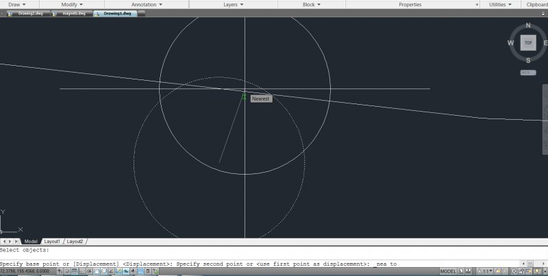

aglaerum Posted October 22, 2012 Author Share Posted October 22, 2012 Why aren't you snapping from center on one circle to center on the second circle? I don't understand why you are using "nearest" on the second circle. "Nearest" to what? If i want the center of a circle to be spot on the Circumference of the other circle, and your answer is not a solution. Quote Link to comment Share on other sites More sharing options...
eldon Posted October 22, 2012 Share Posted October 22, 2012 What is your VIEWRES set to? Quote Link to comment Share on other sites More sharing options...
aglaerum Posted October 22, 2012 Author Share Posted October 22, 2012 It would help if you can post a drawing with just the two circles in it. Here you go, this is right before i click to place, as you see it wants to put it far away from the Circumference. Quote Link to comment Share on other sites More sharing options...
aglaerum Posted October 22, 2012 Author Share Posted October 22, 2012 What is your VIEWRES set to? My VIEWRES is set to 1000, i have no clue what that is Btw... Quote Link to comment Share on other sites More sharing options...
RobDraw Posted October 22, 2012 Share Posted October 22, 2012 Set it to 10000 and please post a dwg. Quote Link to comment Share on other sites More sharing options...
eldon Posted October 22, 2012 Share Posted October 22, 2012 You can see in the picture (which is not the same as a drawing file) that the circle is tessellated. It is a viewing problem on your set up. Therefore I asked for the drawing file to see if it exhibited the same problem on someone else's set up. Quote Link to comment Share on other sites More sharing options...

RobDraw Posted October 22, 2012 Share Posted October 22, 2012 One of your circles is a solid but that is not the problem. After you move a circle, it does appear that the center off of the circle, it is not. After moving, regen and the circle will line up with the center. It can be verified by measuring from the center to the perpendicular. Quote Link to comment Share on other sites More sharing options...

aglaerum Posted October 22, 2012 Author Share Posted October 22, 2012 One of your circles is a solid but that is not the problem. After you move a circle, it does appear that the center off of the circle, it is not. After moving, regen and the circle will line up with the center. It can be verified by measuring from the center to the perpendicular. What you are saying seems to be true, but the visual part is far off, an verry confusing. Quote Link to comment Share on other sites More sharing options...

aglaerum Posted October 22, 2012 Author Share Posted October 22, 2012 Regen is your friend. Sorry but like i Said, Regen does nothing, i can see the lines moving, but so does the error margin. Quote Link to comment Share on other sites More sharing options...
RobDraw Posted October 22, 2012 Share Posted October 22, 2012 There is no error. Quote Link to comment Share on other sites More sharing options...
