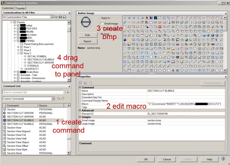

rkent Posted October 23, 2012 Posted October 23, 2012 You will have to go into the CUI and in the command list portion, add a new command for the first one, after you have it set, drag that up into the panel in the first Row, create a Row if you haven't already. If that one works, then copy the first one in the command list area, modify for the next name, drag and drop, continue. You will need each block as its own .dwg file, pick a spot on your local drive to create a library folder, place your blocks there, use that path for the command for each one. Add more Rows as necessary and continue creating a command for each block, dragging and dropping in the panel you have selected. Quote

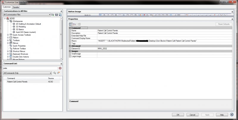

rkent Posted October 24, 2012 Posted October 24, 2012 (edited) No thats what i'm trying to do. How do I do this? You need to edit the command for that block in the CUI, in the macro section use this or something similar ^C^C(command "INSERT" "C:/ACAD/DWG/LIB/singlesocket ") This is using a simple list string, you can use macro's as well, I am more comfortable with this method. Macro would look like ^C^Cinsert;"C:/ACAD/DWG/LIB/singlesocket ";\1;1;0; ; = enter \ = pause 1;1;0; = scale factor for X of 1, for Y of 1, rotation of 0, if you want to be able to specify those then you would use a pause instead or just not show any of that after the \ Edited October 25, 2012 by rkent Quote

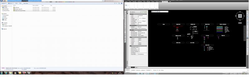

dsibbo Posted October 25, 2012 Author Posted October 25, 2012 You need to edit the command for that block in the CUI, in the macro section use this or something similar^C^C(command "INSERT" "C:/ACAD/DWG/LIB/singlesocket ") This is using a simple list string, you can use macro's as well, I am more comfortable with this method. Macro would look like ^C^Cinsert;"C:/ACAD/DWG/LIB//singlesocket ";\1;1;0; ; = enter / = paust 1;1;0; = scale factor for X of 1, for Y of 1, rotation of 0, if you want to be able to specify those then you would use a pause instead or just not show any of that after the \ rKent I have had a go at what you suggested this morning but I still cannot seem to get it to work. I get a message "INSERT" Unknown command ""INSERT"" when I try your first suggestion and with the second suggestion CAD asks me to type the name of the block. I've attached 2 images of my macro and my file location so you can see if there is anything obvious I am doing wrong. Quote
